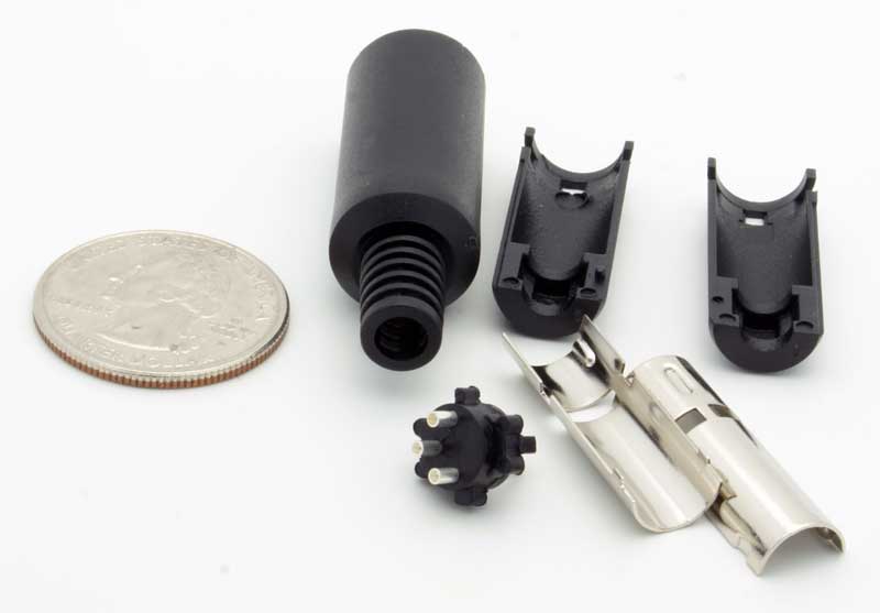

My only problem is the 3 pin charge port. I want to use my Cycle Satiator to charge this battery but I cannot find this type of plug. Can anyone tell me where to buy this plug so I can make an adaptor cable for the Cycle satiator? I hate to cut up the nice 5A charger they shipped with my bike just to make an adapter cable. It looks to be something like a mini XLR, but not key exactly the same.
Is this where I can ask IVY to ship me one? Of course I would expect to pay for it!
The charger plug looks like a 3 pin Mini-DIN, but without the square center post. Do they come without that post? Can you rid yourself of that post?
https://vetco.net/products/3-pin-mini-din-male-inline-plug-connector
Looks like there is no post in this image.
