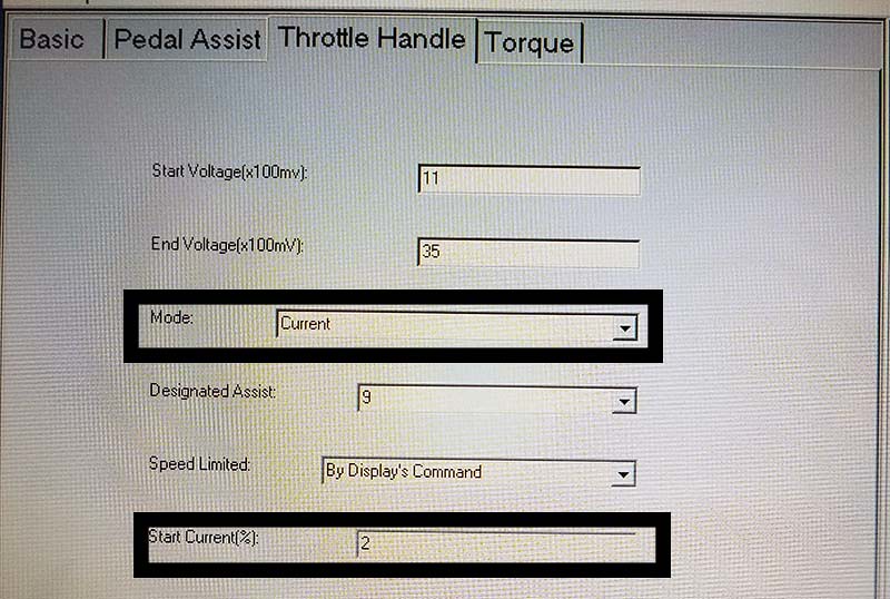

The throttle control switch for my Bafang has been so sensitive that it was almost impossible to engage without the bike lurching forward. I believe I fixed it with the programming utility. Under the "Throttle Handle" tab I changed "Mode" from "Speed" to "Current". That eliminated the abrupt throttle. I also changed "Start Current" from "10" to "2" to see if it would increase the throttle's physical range though if that accomplished anything it wasn't much.
