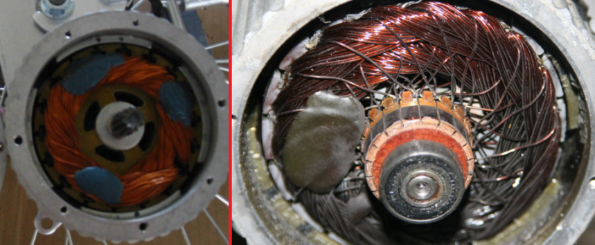

This is a different model that appears to use the same motor, a quick scan might be helpful.
https://www.electricbike.com/2014-ezip-trailz-lithium/
