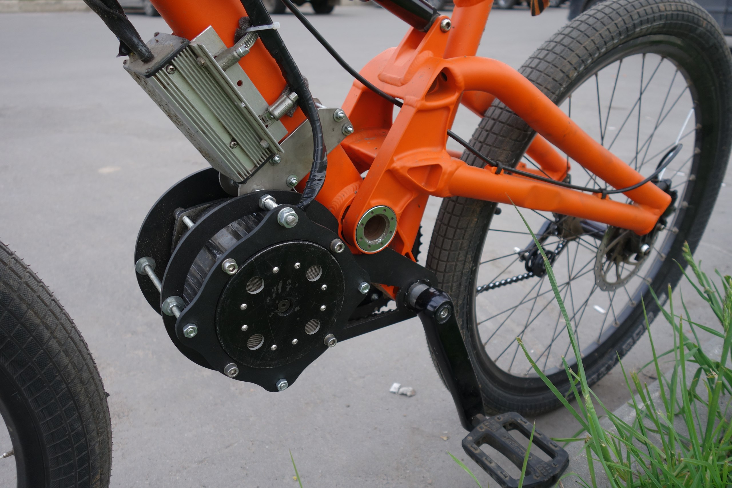

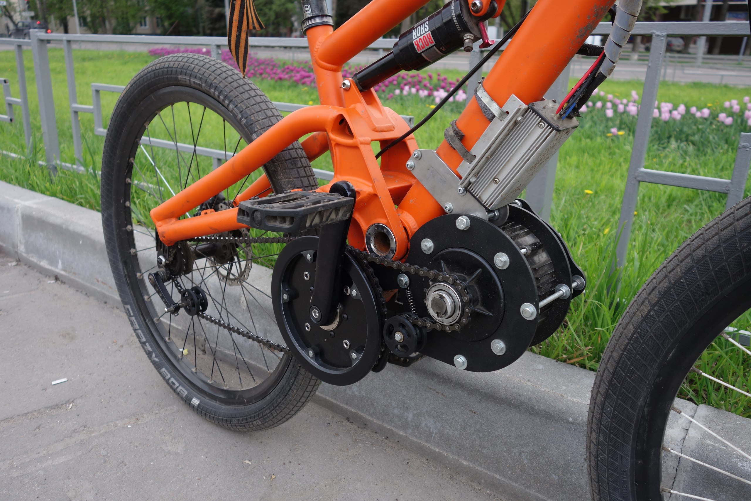

To Nuggets : That looks very sturdy nice work,Those two small flat bars on the non drive side ,may I suggest if you can make a small fold in the center of them (bar will end up looking like a flattened "V" when you look at the tip true its length ) ...that fold would goes from one bolt hole to the other centered in the bar (ahh that's I think better way of putting it) That would effectively make that small bar much much stronger ,I think .I have some planned for myself in a near future . Just a suggestion
