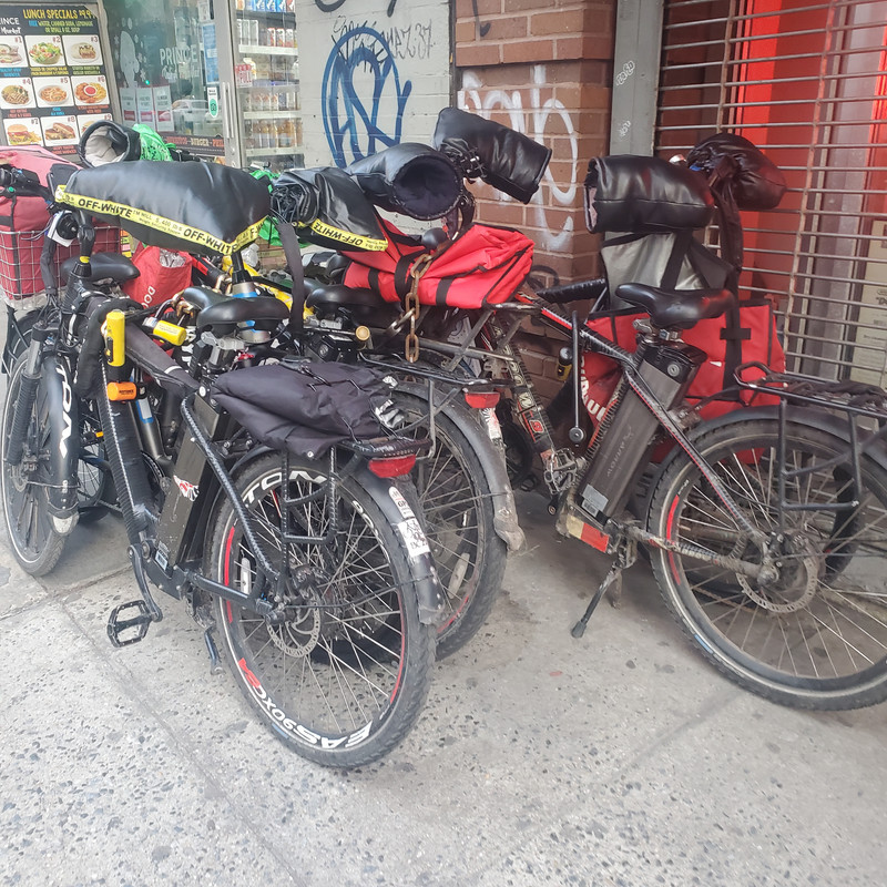

Sadly, I see ebike battery fire stories in NYC becoming much more common. In Manhattan Ebikes (mostly delivery services) are now just as common as Taxis on the road. It's crazy but I still have not heard of any ebike shops in NYC known for offering/building high quality ebike battery packs.
I assume most ebike batteries being purchased in NYC are all generic cell import builds of dubious quality. I'm also guessing that the higher chance of bike theft makes it difficult for many to justify spending $1000.00 on just a quality battery. The most common ebike for deliveries here (Arrow) sells for around $1600.00 total. I'm surprised that ebike battery fires are not more common here.
It will raise prices but I'm all for forcing more safety standards/regulation to imported ebike battery packs.
