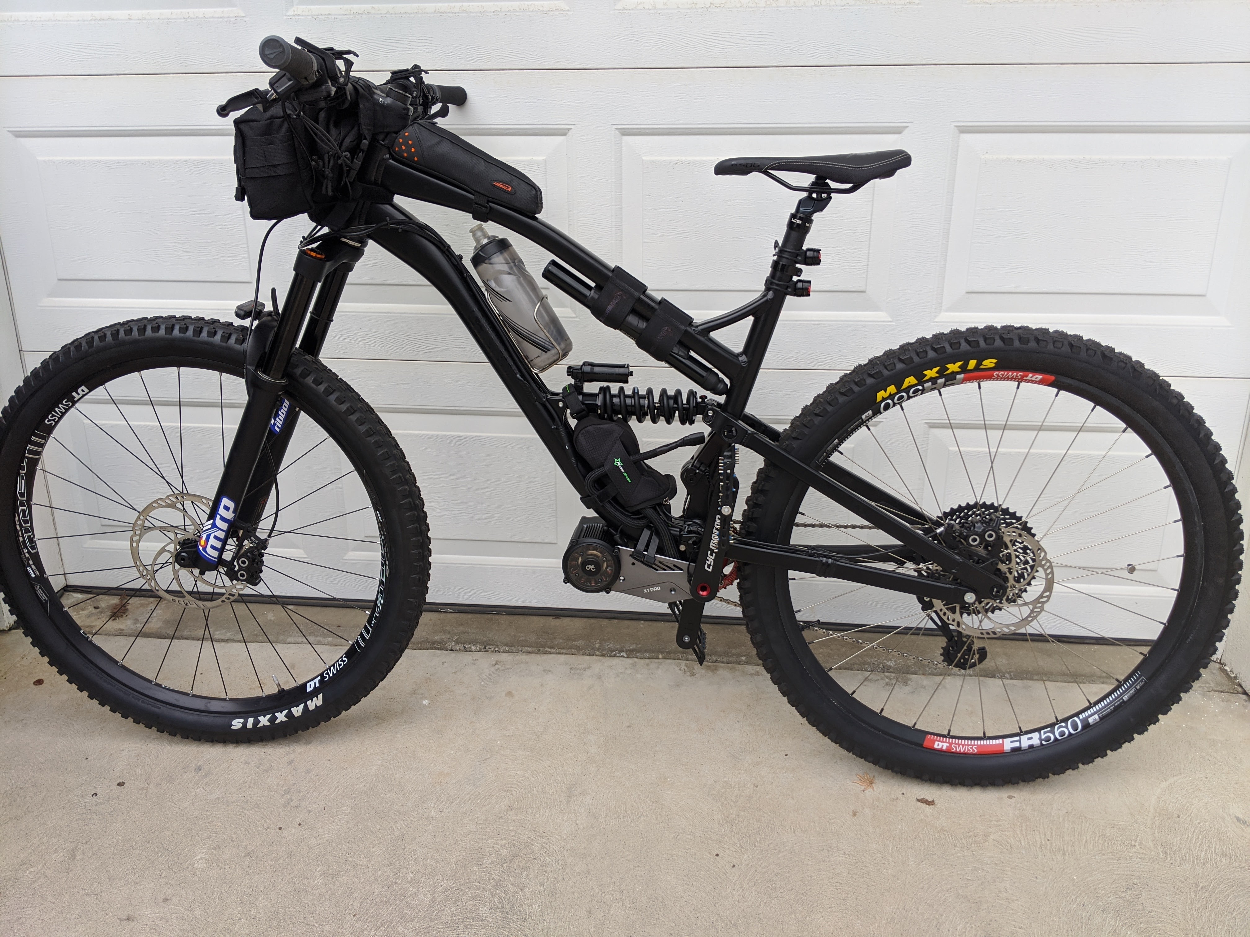

I only ride trails mostly intermediate and advanced trails blues and blacks I get about 20miles of hard lots of ups and downs. All in the North Georgia mountains. I've also been charging the pack to 90% not 100% I've heard this is supposed to prolong the life of the pack and every 5th charge or so I'll go to 100%. I think that is supposed to balance charge the pack. What I don't understand is got the pack down to 11% still read 48v. It's a bit off though my multi meter is reading 48.4v. I've heard keep it above 44v and I should be safe. The vendor said BMS is set to 41v that sounds really low. I wish the EggRider had some sort of audible alarm that's adjustable. So im not really sure where im at other than just continue to monitor the voltage and don't go below 44v?? Or is there something else I should be doing.
