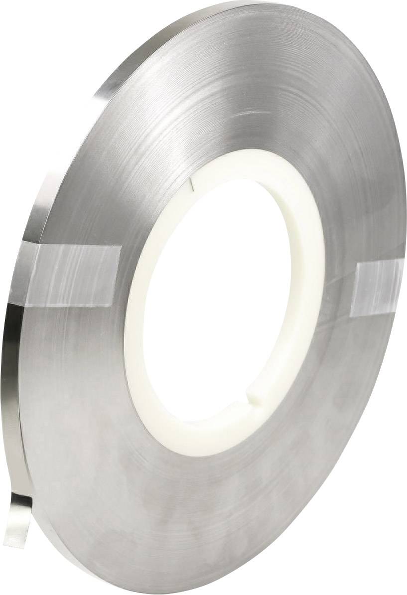

Many pack-builders buy 0.15mm thick nickel ribbon to make both the series and parallel connections. Making the parallel connections first and overlaying them with the series connections is easier. Making the series connections first, and then overlaying them with the parallel connections has less resistance for slightly better performance.
Personally I would never use pure nickel strip for series connections, because nickel has 4X the resistance of copper. Instead I'd used nickel plated copper strips to retain the easy to tab weld properties of nickel as well as its resistance to corrosion.Pure nickel strip is fine for the parallel connections. Cheaper and more readily available nickel strip is fine for the low current parallel connections. Also, I do agree with SpinningMags regarding making your series connections first, though in a 14s pack there are 13 series tabs with 2 connections on each, so in his example making the parallel connections first would send the current through an extra 26 layers of nickel. Plus it is more likely to result in a poor weld to a cell of a series connection.
