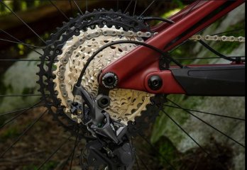

You would need a low gear with a hub drive, but it looks like a front derailleur with two or three chainrings would be possible, and will get you some of taller gears.
Yeah, the top speed of this configuration would be ~23mph, the motor would be doing 11-15mph up hill.
You can get rear cassettes with huge spreads these days, shouldn't be a problem to get the right bike gearing.

The only way I see it being adequate is if she adds a mid drive to help the RH212 get up to speed. Still do we even know if this trike will be able to use a cassette? Or even a mid drive?
Cassette interfaces on hub motors are not known for their strength, so we wouldn't want a very powerful one. It would be very helpful to increase the motor efficiency, but i think we're well over this virtual $1000 limit of we did that.
