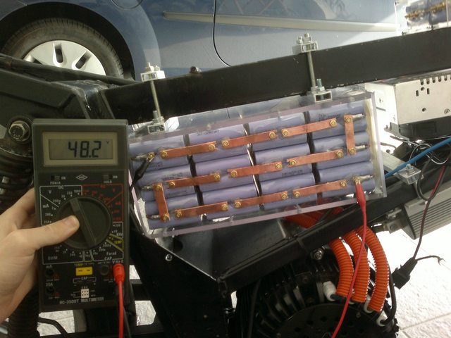

However as a small note on the build i belief that if you are building a performance motorcycle for yourself 18650 cells are not the most financial viable option. The amount of investment required in assembling the pack and developing the casing/bus bars will cost considerable amounts of money, which are not really justifiable for a one-off project.

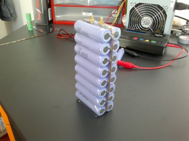

Not necessarily, cells are really cheap, and you can build large parallel blocks and connect them into series later, that's how I did it.
And one older from another guy:
A little imagination is all that you need. However, there is a better way to connect them, I'm working on a perfect solution for connecting 18650 cells, and then it will be piece of cake, no soldering, no welding, fused design.
For low powers this is no problem. How ever for the kind of bike being discussed here (100kw continous) about 10c rating from the pack. Wiring like this will not cope with the heat generated.
The main issue will be if you want reliable constant power cooling will have to be addressed, with 18650 cells this is harder then using flat pouches (geometry).
During my past experience with developing concepts for high powered electric cars, I have formed the conclusion that if you would apply laser welding you can get the best results when using 18650 cells. However this project as so many things revolves around money, so i would strongly recommend pouch cells. This is because of ease of packaging, connections and cooling.
