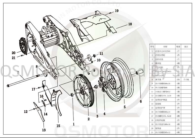

looks cool. think could you mount it to an ebike frame? :lol:
http://www.cnqsmotor.com/en/article_read/New%20QS%20Motor%20Mid%20Drive%20Motor%20Assembly,%20Under%20Developing/572.html
Probably yes, but for legal reason and to avoid attention from thieving little bastards, a used and abused looking scooter is perfect for riding stealth.
Looking at this exploded view from your link gave me an idea. I saw a ship running diesel electric, meaning the diesel engine was running just for producing electricity to a battery bank that run 2 electric motors on the same axle. I was told even if those motor was mounted to the same axle two motors made twice the torque as one.
Dual motor could be possible with custom clamps to mount the second motor above the one that is running the pulley for the belt, both motors would be swing arm mounted. If two motors driving the same axle at twice the torque holds true for that ship, two motors connected via belt/pulley or sprockets and chain will also do twice the torque? One could double the torque yet still keep the design of motor moving free with the swing arm. What do you think?
