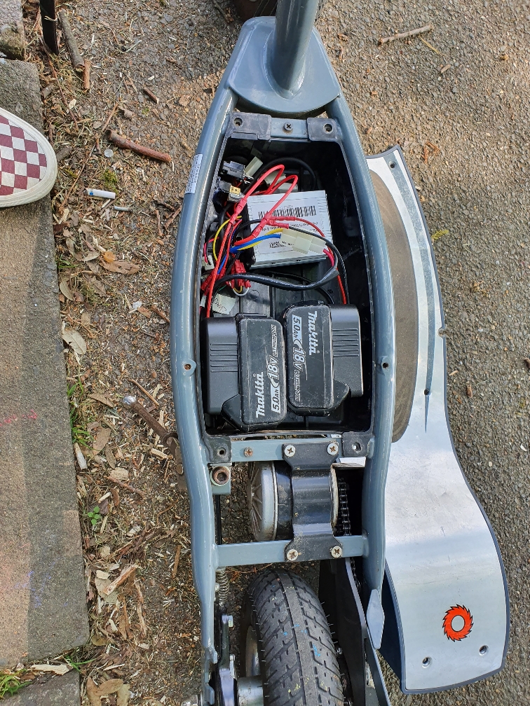

I definitely will do, might do a thread, gonna retrofit a disc brake on the rear, maybe swap out the new motor sprocket for more teeth. I want to nail down a final plan so I can get the bits and get it done. Once it's up to 25/28ish mph I'll be happy with that but still need to work out power, distance etc.
Still plenty of room in there.

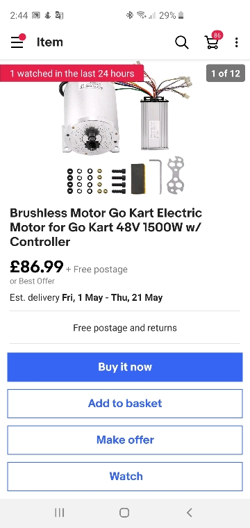

I found one on ebay but looks too cheap, is it the right bit of kit? Do I need to get a new throttle for 54v of battery, my current one is a 36v throttle.
Would I have to mount the motor on top or would it fit in existing place?

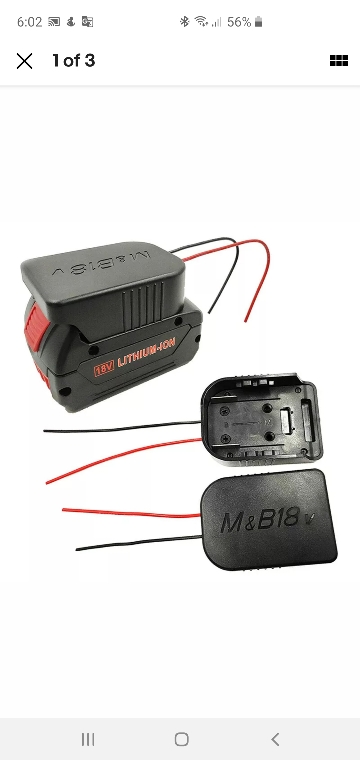

I'm gonna have to use 3 x 18v makita batteries until I save up for a proper battery.

The throttles all are the same 5v item, that seems to be the motor it is fairly cheap make sure it's postable not in China etc or it may get lost I'd wait till this virus is over before ordering out of country etc.

It's a bit of a pain taking the drill batteries out to charge,
Would i be able to get say a 60v scooter charger and bodge the bits together to charge them while still within the scooter or would that just mess my batteries up?
Sent from my SM-G975F using Tapatalk
The charging will be an experiment of your own by there if you open them up I'll help along the way but without seeing what a been used it's hard to say it's safe.
I have a look at the output current on the charger and then match it to the new charger, my drill charger is 40 mins to fill on a 5 amp batt so it's about 7-8amp I imagine so keep the same time to charge them u be fine.
