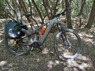

Just a quick update, finally got around to realize this project over the holidays. The fork extension is made of stainless steel tubing with tool steel inserts at the end where the holes for the hub axle were drilled/filed. A custom rear fork with suspension is in the works. The hub is an MXUS XF15, I wanted something lighter like a Q100 but now quite happy with it, it delivers nice amounts of power pushing me and the cargo uphill while barely getting warm to the touch. We'll see in the summer, I can always add a thermistor if necessary. It is driven by a Flipsky 75100 which is controlled over BLE in PAS mode only. The battery pack is a 13s7p 18650 Samsung 29E with a 30A BMS, I'm planning to build a second identical pack for the long journeys.
Some pics, excuse the dirt, can't be bothered to wash the bike :)
Looks good. :)
As long as the dropouts/toolsteel inserts are such that the torque from the tiny axle flat contact areas can't cause the axle to rotate within them, it should be ok over time. The wider the dropout / insert flat face that holds the axle are, the greater the surface area contact between them, and the more torque that can be transferred from axle to frame (and so the harder the wheel can push against the ground).
After flattening the tube I hammered in a tight fitting piece of flat tool steel approximately the length of the flattened part. Then I drilled the hole for the axle to 10mm, then I filed the hole to 10x14mm to fit the axle plus the toque washer (which is on the inside of the fork). Repeated for the other side. So basically the torque arms are inside the fork tubes. Hopefully they will hold up. Here is a pic with the washer removed:
Something to consider when designing the replacement suspension setup: If the torque is high enough, you might run into issues where the hard tool steel cuts into the (probalby softer) axle metal. This can happen in those cases:
https://endless-sphere.com/forums/viewtopic.php?f=2&t=26444&p=1746140#p1746140
https://endless-sphere.com/forums/download/file.php?id=328959
and can be minimized with a much wider (as much as possible) contact surface area between the axle flats and the as-perfectly-fitting-as-possible dropout/torque plate. (a clamping style dropout is perhaps the best way to make the tightest fit; there are numerous examples in above-linked Torque Arm Picture Thread if you need to do that).
