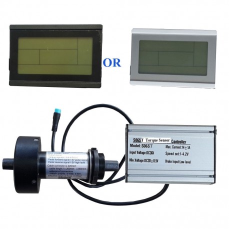

A KT controller equipped bike is not torque sensing! They do not make a controller with the ability to read/have an input from a torque sensor.....
that's wrong. BMS Battery had a bundle of a (poor) torquesensor and a Kunteng controller (branded as "S06ST") for many years:
But who wants to use a Kunteng in these days? It's totally outdated, I can't understand why it's still that popular 🤷‍♂️

Wasn't talking about a history lesson. Maybe a I should have said KT does not have a controller available TODAY capable of accepting torque sensor input. If they did have one, personally I wouldn't mind giving it a try.
You're entitled to an opinion regarding them, but I think they're tough to beat for most applications. Agree to disagree if necessary.
