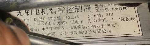

Hello Guys,
I scored a deal on them batteries about $60 each. I wanted to keep the batteries as they are, since I have Milwaukee tools.
My controller is a 36 volt controller.

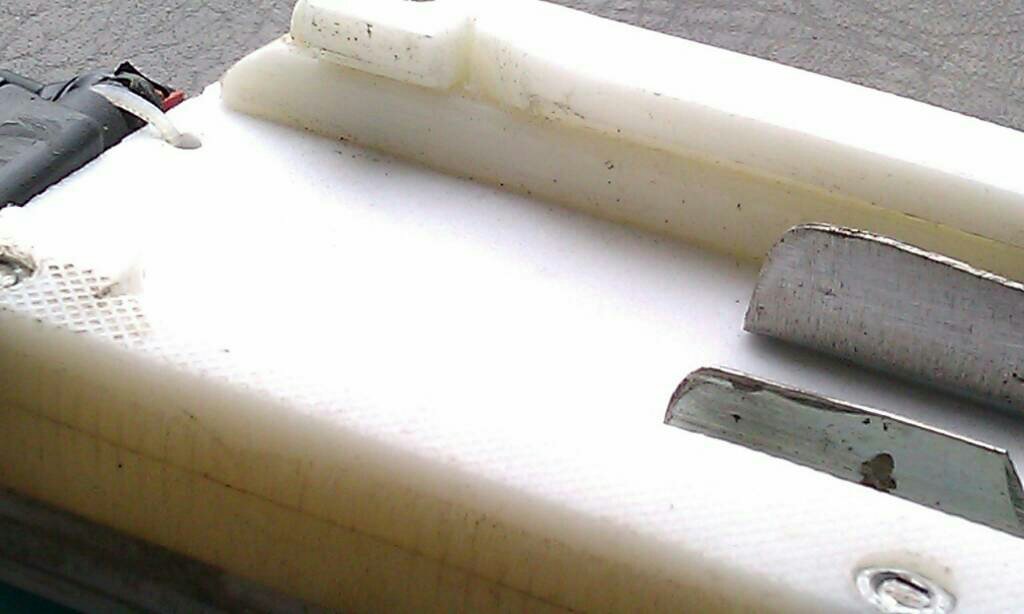

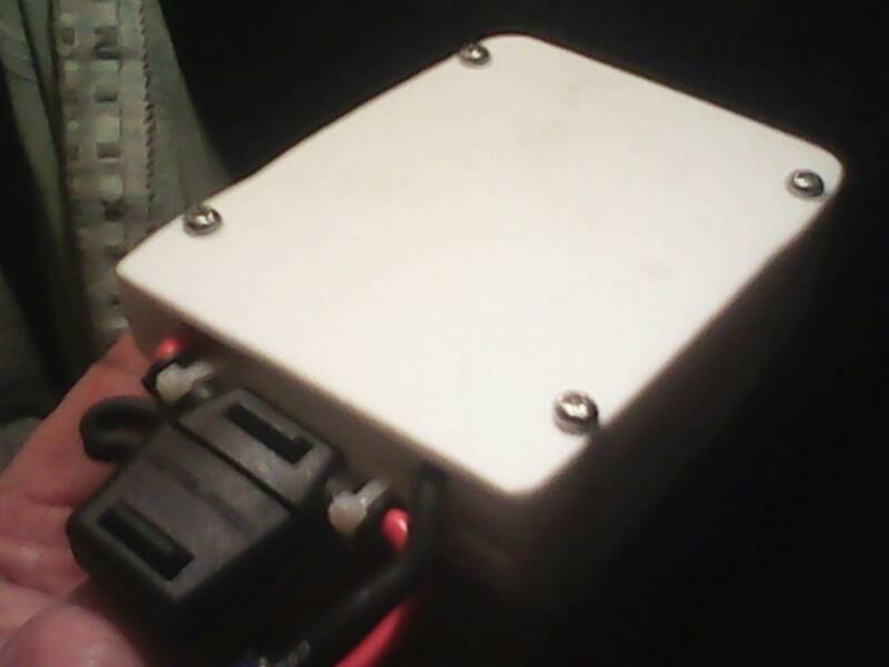

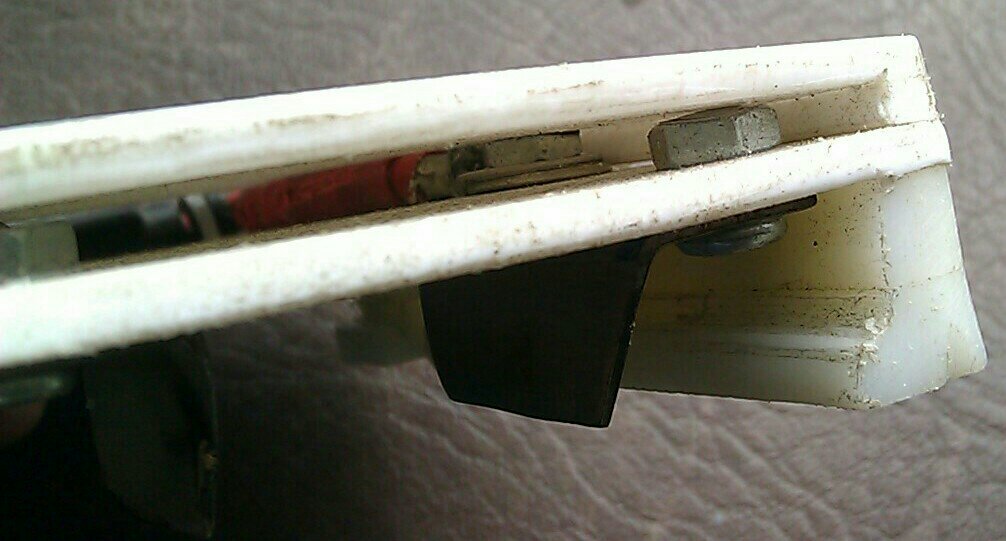

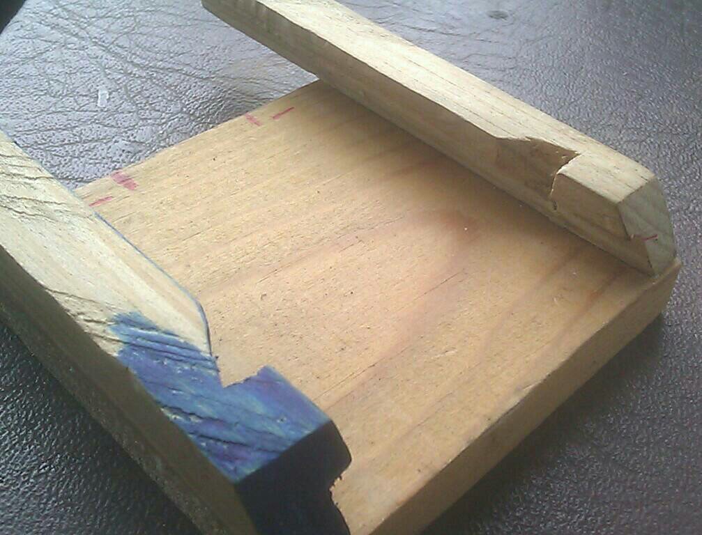

I use two 36v lawn mower batteries on my 250w xiongda in parallel,charge separate with there own chargers. Only hook them together when they are the same voltage. I made adapters for them using plastic kitchen chopping boards.
wooden prototype
See small battery bargain thread on pedelecs forum for more info.
