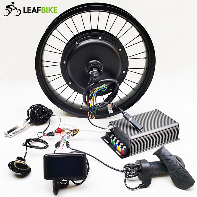

By my napkin sketch reckoning, 30mph will take about 1750W electrical, and 45mph will take over 5000W electrical to hold on level ground. Optimizing for one speed will impair efficiency at the other. Timely acceleration to either speed will require more juice than holding that speed. So if you want 45mph, plan for like 7kW electrical. (Or don't, because your bike will suck.)

Hol' up, i got real world numbers on this motor.
30mph = under 1000w ( efficiency sweet spot )
45mph can happen on about 4000w with max effort pedaling and a massive chainring.
Motor will need some additional cooling help in order to hold 45mph for longer than a few miles. 40 mph for long stretches works, 27.5-30 mph is the sweet spot for range.
You WILL need dual torque arms on this motor, it's a beast. I don't recommend a 4T ( default winding ) unless you have a battery a lot more capable than what leafbike sells.

I assume is 45mm stator as compared to the 35mm stator as found on the 1500 watt leaf bike kit).
I wouldn't assume that, the 1.5kw motor is more like a 2kw motor in reality. Could be the same motor dimensions. Ask leafbike
Looking at the direct drive motor diagrams on the leaf bike website the 2000 watt, 2500 watt and 3000 watt all share the same dimensions. The 1500 watt is distinctly different from the 2000 watt to 3000 watt range.... as is the 750 watt direct drive and 1000 watt direct drive which are different yet again from the 1500 watt motor.
I could be wrong but you should ask.
A wheel significantly smaller than a 26" will produce more than 2000w continuous easily.
I agree asking is the only way to be certain (the diagrams could be wrong)....but for the record the kits I looked at in the 2000 watt to 3000 watt range were indeed 20".
In fact, I just noticed now there is also a 5000 watts 20" kit that also uses the same motor as the 2000 watt to 3000 watt kit:
So I'm thinking the 2000 watt probably does use the wide stator since they scale the motor up to 5000 watts.
