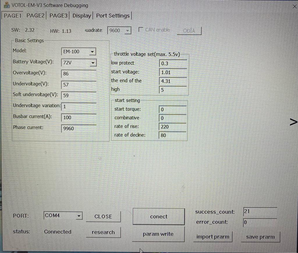

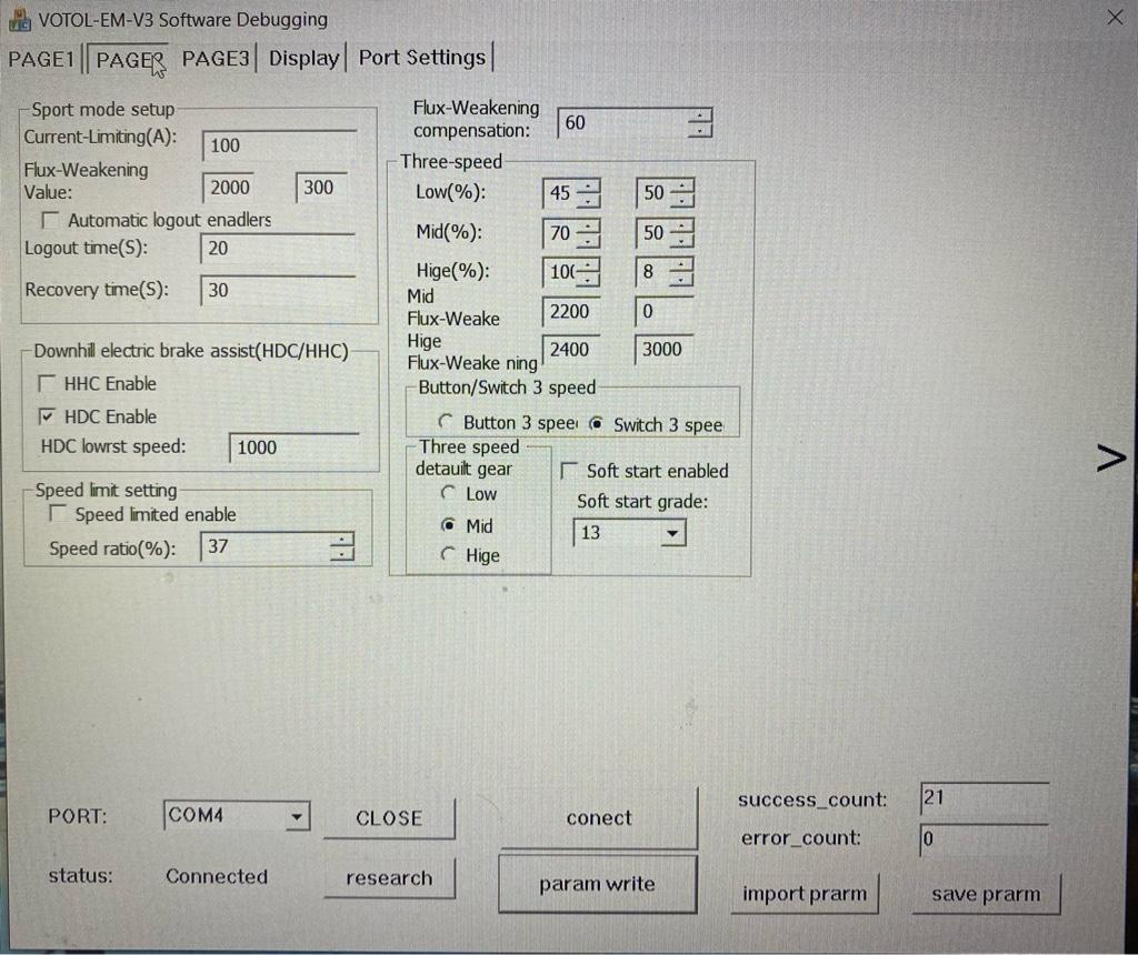

Edit of my previous message :
I managed to fix many of the setting,
now i'm stuck to calibrate the voltage and i dont know what value to put on "Current cal" and flux cal" if i press the "switch" twice and adjust the voltage and "save parameter" it save but when i turn off and on it didn't save it
i read the topic it seems i have the latest software and i dont know how to get the previous like some guys have or to get to save on latest.

Should it be a QS motor 205 2000W !? Then 16 pole pairs and hall angles are 120 ', probably more correct! ??
Important: with every change, save! .... switch off! ..... switch on! .... check!

Aaaaah i didn't turn it off after save i just tried :( , could it damage the controller ? , well they told me its 24 pole and -60 hall angles.
i edited my other message as i fixed some setting :),
now i'm stuck to calibrate these 2 value Current cal" and flux cal" i have no idea what to put.

thank you :) i spend days on trying to adjust/playing with, yesterday i tried without load at gear 3 reach 980rpm , on road i reach 80khm ( i think its a little too high for a 2000w ?) anyway as for now it seems to work fine for me .
The only big problem is that my bms show me insane discharge current and i know its not the truth ( 180-210a when accelerating) i have no idea how to calibrate the current value on calibration mode ( i mean what number to put, now its set to 75).
Qs helped me to adjust some value, but im still stuck for current calibration.
i post my setting hope it will help some other guys [emoji106]
Battery 72v 150a, em 100s , Qs 2000.

hi guys, i have a simple question let's say even maybe stupid, what is the purpose of the area of "start voltage" and "the end of voltage" i have a deadband at 1/4 when i twist the throttle before it really start, do you guys know what value should i put if i want to start immediatly ?
Envoyé de mon iPhone en utilisant Tapatalk
deida789 said:
.. do you guys know what value should i put if i want to start immediatly ?
Hello, hall sensor throttles normally start around 0.8-0.85V so part of the issue will be your 1.01V start setting if you've got a hall, it is too high.
To complicate things: a lot of the hall throttles do not change voltage signal until 1/4 of the throttle so this deadband could be built into the hardware. I have a guide in my threads how to remove the deadband on wuxing hall throttles, search my threads for "guide". This fix will work on many of the hall throttles since they are similar in hardware function.
For potentiometer throttles the voltage can start to increase almost immediately so in theory you can set the deadband better.
j bjork said:
start voltage is the voltage where you want the motor to start.
"End of the" is where you want full throttle to happen.
Measure the voltage from your throttle and determine at what voltage you want it to start.

deida789 said:
thank you Iarsb, that's pretty weird why it is made like that
It's a safety feature so it's actually needed. It's only that the design has too much deadband..
