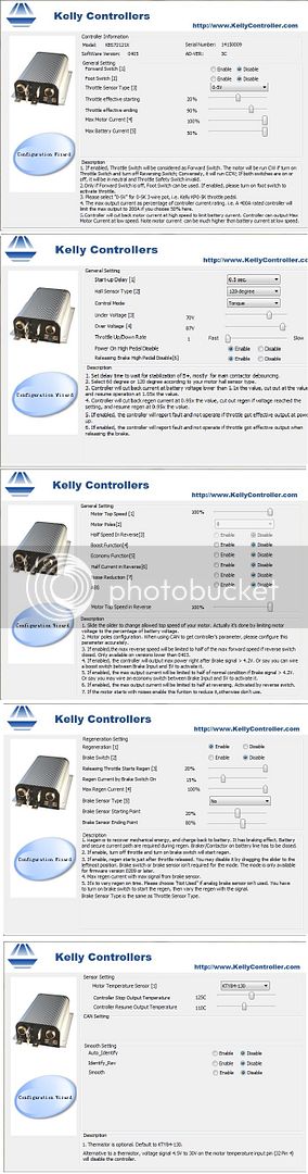

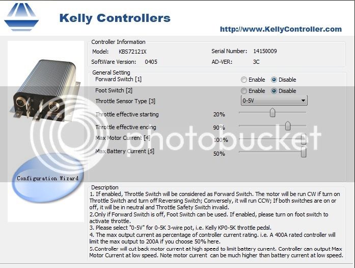

Wow! Well either I don't have the shunt and CA setup right to read amps or my controller settings are limiting. Hard to believe there is more in it. It feels potent as it is. Can those in the know take a look at these settings to determine if I am missing something? I have the boost setting disabled because I believe it should only be enabled if you want it to be switch activated? I am assuming it uses the boost functionality automatically otherwise?
I have a 0.5ohm shunt and wired per the diagram in the CA manual and set the shunt setting to 0.5ohm in the advanced setup. I assume this would be correct.
Do you really mean 0.5Ohm and not milli Ohm?
If your shunt is on 0.5 Ohm a 50A current will yield a 25V voltage drop over the shunt that will seriously affect your performance.
Yeah I meant mOhm. Sorry about that. I decided to enable the boost setting to see if that was the difference but it did not do anything. Do I need to trigger that somehow with a signal?

can you plz post the settings pic in higher resolution? i can't read anything.
i have a 48V/120A one laying around, it can be configured to 70% battery current

Sorry didn't realize how low that resolution came in.
No videos as of yet. Have to dig out my go-pro. I have now past 250 miles on the bike. Most of it offroad trail riding. about 16-20 miles per day. I use a little over half of my pack capacity doing "spirited" riding. No problems as of yet. All I have been doing is charging, keeping the chain lubed, and riding.
crossbreak was kind enough to send me the earlier version of the KBS software that allows 70% battery current. I suspected that they just changed the software to disallow folks to run 70%. Fany said they did this to protect the controllers. She didn't say how but I figured it was just a software change and it was. This morning on a full charge I saw 120A peak which is 40A higher than I saw with 50% battery current. I can tell a difference in the initial "hit" but overall acceleration didn't change much.

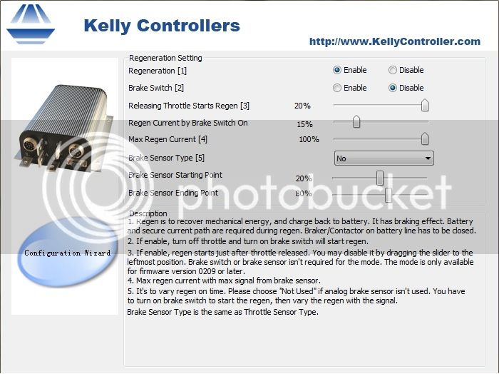

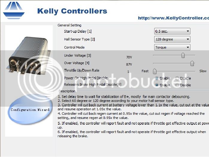

I am trying to figure out how to remove a slight delay in throttle response on the Kelly controller. Any pointers?
you can reduce the V range of it : (ex: 1.2 to 4.5 if it's a hall throttle , up the Low value until you get no dead zone,(keep a very small one to be sure to get 0
if it's a delay you want to change, there is a value of refresh timùe to lower as I remember ...you can post a screener of the settings if you need help
Dan, the settings I can adjust are in the screen shots above. I believe that I have the throttle effecting sliders adjusted in a way that matches what you described. I don't know what else to change. I am going to disable regen and see what that does. It even seems to have a minor delay when releasing the throttle I think I got used to it but a friend rode the bike and asked about it. Now I am trying to fix it because it's pretty noticeable when I am paying attention to it while riding.
