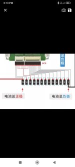

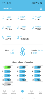

I have the 6-22S auto identify BMS from IC gogogo on AliExpress.
I'm using a 13s battery and have it connected like this:
I had to set it to 13S in the cell num field, this didn't change the cell numbers displayed in the app immediately so I did a reset by unplugging the balance wires.
It should display all voltages correctly now. If you leave the big b- disconnected B1 and B2 will have totally wrong voltages.

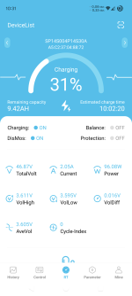

Hi Guys!
just put in service a 13s7p battery with a JBD-SP14S004 bluetooth BMS.
Some questions if anyone have any idea:
* some configuration recommended other than setting it to 13s ?
* is it normal than when I charge, "DisMos" is on and "balance" and "protection" are off ? I would have see it the other way...
* How much voltage difference is tolerable between cells ?
I was 0.011 when initiate charging now 0.021
*there is a switch pin on it, it is not documented in pdf, do you know how it works ? if I put a switch what will it do in shorted position ? I tried to short it shortly and I didn't see anything happen, was keeping charging like before.
Thanks!!
Protection off just means that there are no fault conditions.
You have to turn switch function on first, if you short it discharge gets enabled.
It will accept a charge no matter the switch position.
