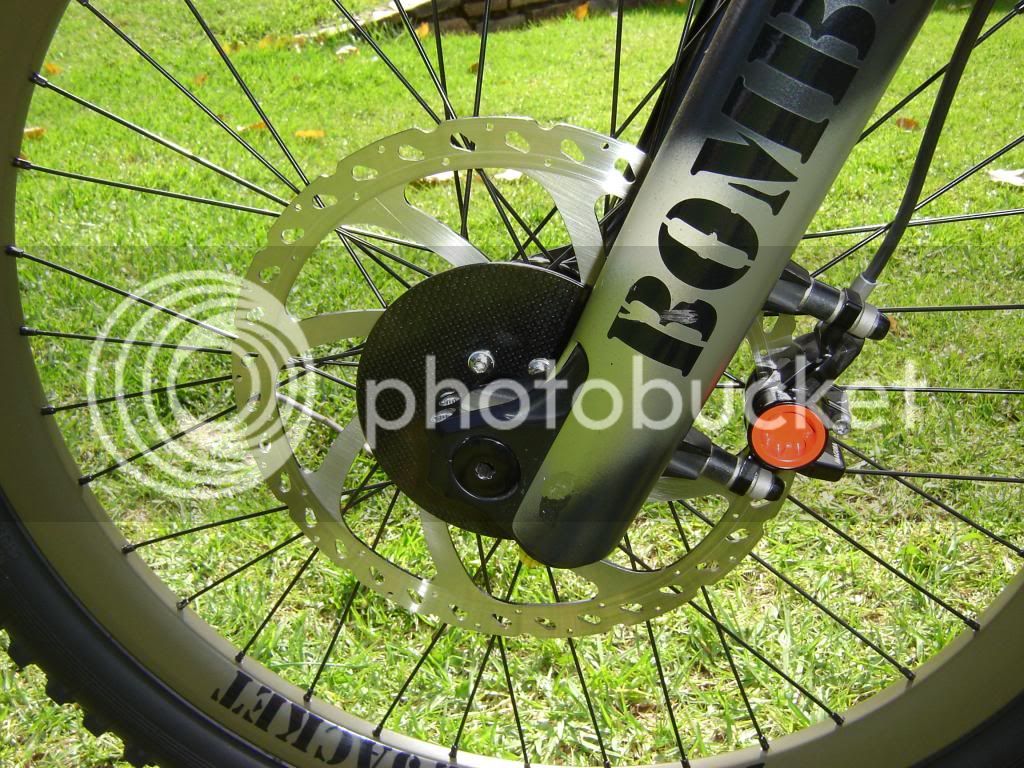

HI guys, thought I would just share a bit of info re the application of 9" rotors. The following 4 pics show the fitment to the Bomber showing the spacers necessary on Maz 888 front forks and rear I.S. swing arm mount using 203mm adapters and concave/convex fitting shims. These adapters provide the extra clearance for post mount calipers and also allows for x and y axis adjustment so that if any surfaces are out of alignment these spacers will correct this and allow for perfect alignment of the caliper pads to the disc rotor front and rear.

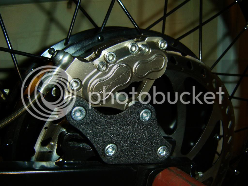

The gator brakes are a whole different story and are quite a pain to fit 9" rotors to these I.S. calipers. Here is a pic of the spacers we manufactured to allow the 8pot gators to fit the 9" Hayes rotors.

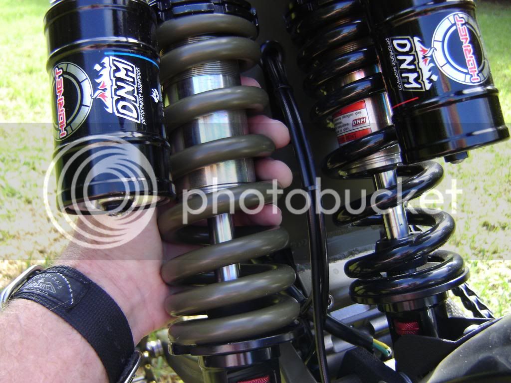

Also the latest Bombers are being supplied with a different spring on the rear DNM shock. We have been riding around on one of these shocks for about a month now and can confirm that the new spring style is heaps better than the old version. A lot plusher ride at high speed and "seems" to have a lot more adjustment range than the old style. Below is a pic of the two versions green being the old type and the black the newer type. The new version spring is also thicker than the old type by .5mm heaps heaps better. Here is a pic of the 2 side by side.

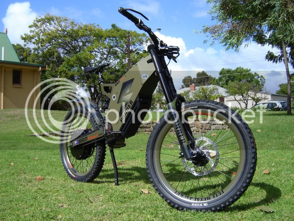

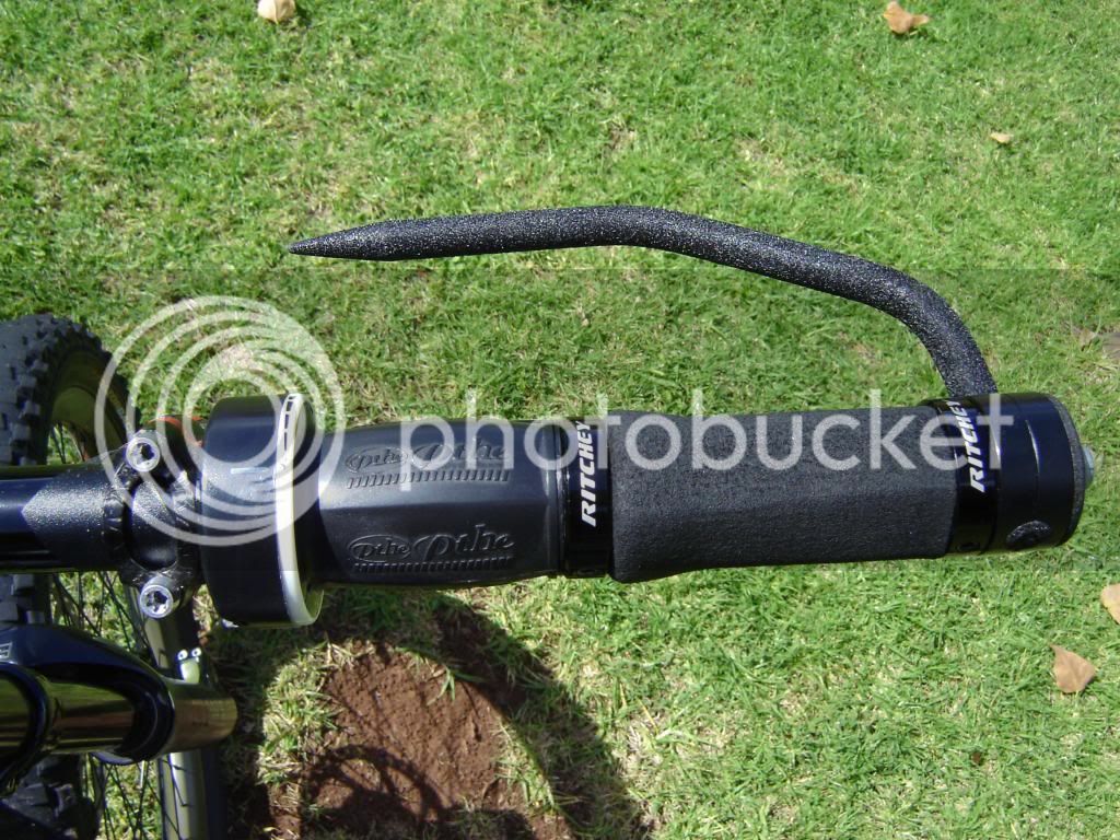

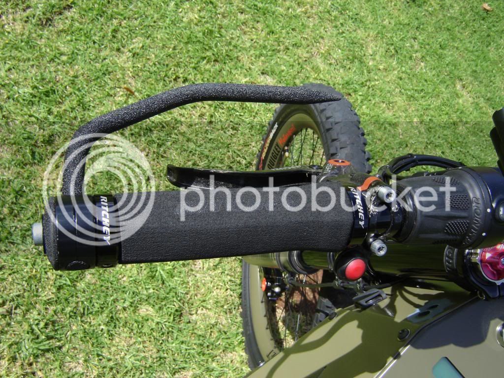

Here a some general pics of our demo with a few upgrades recently done, bar ends, grips, rear shock, new 9" rotors and side cover touch ups. Sorry about the OS pics, using new software. :roll:
Very nice green Bomber Q, you know how to outfit them nicely. Here are some pics of my 2012 888 with the 9" rotor. For me to get the 9" rotor to fit with the 6 Pot gators, I cut 12mm off the disk posts on the fork legs, then lapped them so they were in line and flat so the caliper would line up with the disk. It was PITA with a capital P to get things perfect and not dragging. Originally even with the 9" Hayes V9, the posts pushed the caliper outsid of the rotor. 203 (8") would fit at all no matter how much I cut the posts. But cutting 12mm off the posts, and using some custom ground 6mm spacers, which aren't 6mm now, I was able to get the disk and caliper perfect.
Hey Rix, thanks mate. Yes the fitting of the 9" rotors to the front forks with IS brakes is quite a pain in the A, and as I noted we knocked up the adapter as I posted. I really hate cutting the post mounts as they can weaken the mounting area substantially and it is also difficult to get a square alignment so using .25mm shims and the 2 adapters worked out great but thankfully Stealth are supplying post mount brakes now so all you need are 10mm spacers and a couple of shim washer to get it perfect. The Magura calipers are soooo much easier to play with.
