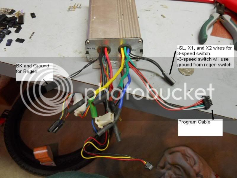

I am having trouble programming my controller. I have everything installed correctly but when I try to transmit, it fails. I have read that I need to disconnect any peripherals such as the throttle from the controller. I did, and the transmission still fails.
I tried soldering a 16v 100uf capacitor to the red lead of the usb cable. That didn't work so I took it off.
I am using my laptop with windows xp sp3.
What do I have to do to get my controller programmed?
Here is a picture of my controller and what I added to it.

Can you post a pic of the programming port / cable you added to the controller.. that should use a normal 846 pinout (skips the middle pin, VCC GND to right RX/TX to left)...
Check your RX/TX to your TTL adapter?
What TTL adapter are you using for this (so I can check the pinouts)?

I got my usb-ttl cable from lyen. I installed it exactly as he did - I will try to find the picture I found. I would take a picture myself but it would take 30 mins to open it up and take one..
This is how I wired it -

I saw a picture (from lyen) where he wired it the same way and my wires looked just like he did. I am very confident I have it wired correctly.
So you have an EB212-XX-XXX model controller? What did the model number inside indicate?
I ask because the EB812 and EB212 use different pinouts, the one you posted is for a 212 using a 116 I believe (though I suppose there could be some 212 using 846 mcu).
- Mike
Ahh, that must be it. I have the EB212-A-3 board. The software has an option for the EB812 but not the EB212.
My board (before modification) -
Do I need a different version of the software?

OMG IT WORKED!
I was using a different version of the software,, probably the old version. I switched to Method's (which has more options) and now I'm in business! :D :D
Thanks for the help mwkeefer!!!! :D
