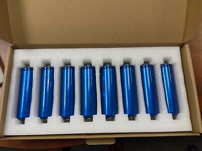

I recently had a LFP battery fire while running/discharge.
Out of 24 cells only 6 salvageable. Three or 4 were reverse polarity. 60 amp fuse ground side and 60 amp DC breaker / kill switch before controller positive side did not blow or trip.
A 12S active cell balancer started smoking and caught on fire after awhile and after disconnect. I had about 5 minutes to push it home.
It smoked and ignited the plastic awhile I fetched a metal pail and placed over top by rail road tracks in gravel.
It went out quick as lithium iron phosphate needs external oxygen where lion has its own oxygen and can burn for days.
Why I bought them. They were out in rain about a week before recovering the 6 cells. LOL
8 Ah Headway cells used. Was 12S - 2P. 10 amp charger.
My guess the balancer did not keep up with the demands. I will need a 5 amp active balancer and 5 amp charger.
The balance could not keep up with the charge and discharge cycles. I ran a cell bank either too low or high ????
Reading was - negative 3V though on a couple reverse polarity cells ?????
Like to hear feedback on that. Above my head.

If you had cells that actually reversed in voltage, then you have at least two problems. The cells were significantly different in capacity from each other, so that when some of them still had capacity available, others had already not only run out of capacity, but were now being driven negative by the current flow thru them from those cells with capacity remaining.
Your BMS (if any) did not work; it's either defective or the wrong kind for the cells or setup wrong if it's programmable--it's LVC should have stopped discharge on the cells long before they got that far.
Your controller (or whatever is being powered by the cells) should also have stopped discharge with it's own LVC. If it didn't, it's also defective, or setup wrong, or the wrong controller for the pack voltage used.
If you need a balancer, especially a high current balancer, the cells are very different from each other and aren't going to make a good pack together.
To make a good pack, choose cells that are identical (matched) in characteristics (internal resistance, capacity, etc).
If they're well matched you wont' even need a balancer until the pack ages so much (over years of time, many years for good cells used well-within their limitations, not pushed hard) that they begin to become different.
All the balancer does is make all the cells the same voltage at some point in the discharge curve. It does not fix anything, or make the pack better, etc. It can allow you to use a bit more of the pack's capacity depending on how bad the problems with the cells are.
Fuses on balance wires...there's a number of posts and threads about those that work out the details of doing it and what reasons there are for doing it (such as shorted balance wires, or an internal short in the BMS that could drain a group quickly...but a failed balancer can still drain the group, and yo0u can't fuse against that or the balancer will blow it just doing it's normal job).
Fuses on cells might (if setup properly, with the right values) protect against cells that suddenly fail very low resistance internally shorted from draining the rest of the cells in the same parallel group--but if the fuses are not very small, they won't blow under most of the circumstances in which cells fail this way and the rest of the cells will still drain. Threads about those, too.
None of these would have helped your situation, which was caused by cell reversal which was probably caused by badly mismatched cells.
Given the situation, mismatched cells, fire, and rain, I would not re-use any of the cells. It's probably asking for another failure that could lead to another fire.

Why I need a 5 amp balancer is for used and tired lfp from Battery Hookup.
It is why their 8 Ah Headway cells were only $5 each. Now $5.50. I also bought 26650 cells when they had them. They seem to be a little more stable ; but the Headway cells not so much.
I got rid of the 6 Headway cells that I salvaged from the fire as even under a 1 or 2 amp load from 12V lights. The voltage dropped to around 6V after running the lights for a few hours. Was not me running them though so not sure but better safe than sorry.
I built a 3S - 3P Headway pack from the cells left over that did not burn but tested < 4 Ah when I got them from Battery Hookup. I have two 5S - 8P packs from 26650 cells and one 7S - 8P. All the same cells - 2.5 Ah - A123 cells.

It's because your cells are mismatched, so they don't have the same capacity. When you discharge the pack to the capacity of the higher-capacity cells, the cells with less capacity are overdischarged to the point where current still flowing thru them from the other cells charges them in reverse, which you can also think of as discharging them into the negative (like overdrafting your bank account).
The balancers don't cause the problem (but they don't fix it either).
A properly-wired up correctly-designed completely-functioning BMS that properly shuts off discharge when a cell hits LVC will prevent the overdischarge of the low-capacity cells.
A BMS that either isn't wired correctly (like using the charge port for discharging, or bypassing the discharge port for higher current, etc), or that is damaged (discharge port FETs stuck on), or that is incorrectly designed or built, such that it can't stop discharge once any cell hits LVC can allow overdischarge and even reversal of cells, and cause fires.
To prevent the problem you don't need balancers, you need matched cells, meaning cells that are all the same capacity (as close as you can possibly get them, identical if possible). And same internal resistance(as close as you can possibly get them, identical if possible).
Balancers do not fix differences in capacity.
Balancers *only* fix differences in voltage, *at a specific state of charge* (usually full charge).
So if you have 10 cells in series, 7 of which are 10Ah, 2 of which are 9Ah, and one of which is 7Ah, the *entire pack* is only a 7Ah pack, because if you try to take 10Ah out, the 7 and 9Ah cells will be destroyed and reversed, with the potential for a fire (even with LiFePO4).
All a balancer could possibly do with a pack made of those cells is to make them all the same voltage. For instance, if you fully charge it and it's balanced to say, 3.65v per cell, so all 10 cells are 3.65v. Then you discharge the pack by 6Ah...the 7Ah cell will be lower voltage than the 9Ah cells, and those will be lower voltage than the 10Ah cells, so the pack is now unbalanced in voltage again.
When the pack is recharged, the 7Ah cell will fill up first because it takes less to fill it up since it is "smaller", so it will end up higher voltage than the others, and charging will stop (if the BMS works like it should). The 9Ah cells will be fuller than the 10Ah cells too, for the same reasons. The 10Ah cells will be lower in voltage than the others, so the pack is now still imbalanced. The balancers will drain down the 7Ah cell until charging can restart, then as cells fill further the process will continue, starting and stopping until all cells are at the same voltage....but they will still be different capacities; you cannot change that.

If no cells burned, then reversal probably didn't cause the fire.
The parts that caught fire would more likely be the cause of the fire.
There is a chance that a reversed cell's negative voltage across the electronics of a balancer or BMS channel could damage that channel, but I don't know if it would cause enough current flow thru the damaged electronics to heat them up enough to start a fire.
It's more likely that a wiring short or other fault (such as from a pinched balance wire shorting across cells) could cause a fire. That's been a strong suspect in a number of battery fires (it's difficult to know the exact cause since most battery fires dont' leave enough of the pack to diagnose).
Another thing that can do it is if the wires are too thin, so the current thru them heats them up enough (especially inside a casing or wrapping that traps heat, which is true of almost every battery) to ignite their insulation or something contacting them.
That can be the actual charging wires if charging at high current, or the balance wires if you have a high-current balancer, etc.
It can even be a poor solder connection or crimp in any of the high current connections--the resistance of the problem point creates heat, and enough heat in one spot can start a fire.
You can carefully examine the burned wires and parts and often see where the original ignition point was; you may have to view them in direct sunlight, using magnification of some type, to clearly see everything though. Overheating usually results in discoloration of metals that may survive the fire itself, and look different than the heating that happened to the rest of the burned parts from the fire itself.

I just ordered 63 more A123 cells from Battery Clearinghouse.. The reason is I built a total of four lfp packs.
Two - 5S - 8P - A123 cells.
one 7S - 8P - A123 cells.
One 3S - 3P - 8Ah - Headway cells ( used and < 50% capacity.)
Even though I have two 48V ebikes running I mostly just ride the 20" ebike with the 36V - 1,000 watt motor and 800 watt controller. Therefore I am mainly running the two 5S packs in series with the 3S Headway pack.
Since I am charging 13S lfp with a 12S lfp charger I no longer even need to balance with my external balancers. However when I do run the two 5S packs in series with the 7S pack for 56V and 17S I then need to charge and balance the 5S packs in parallel so they are about the same voltage as the 3S pack.
43.8V / 13 = 3.36V charging voltage. It has been about six run and charge cycles and the packs including the 3S - 3P Headway all rest between 80 and 90% without any balancing.
It is a no brainer to build a 6S - 8P pack with the same A123 cells to put in series with the 7S - 8P pack for 13S - 43V. I will then have 13S - lfp to run and 13S lfp fully charged on stand by. I cold even haul 13S - 8P in a rear basket for longer range like up to 15 miles.
