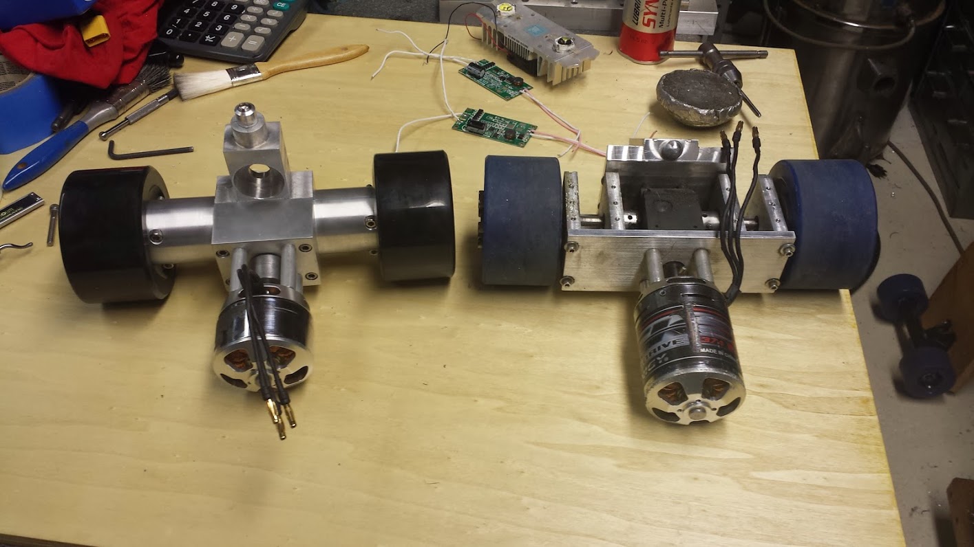

This is my first board the Outrunner Board, It was built for a class project. I wish I would have found this website back then, we could have made a better board.
Specs are:
Sk3 5055 320kv motors
HTD 5M 12/36 gearing
3d printed hangar clamps
cnc cut aluminum motor plates
Hk150 esc w custom heatsink
Turnigy 6s 5.8ah x 2
Custom Omen Kush 16plies
Orangatang wheels 3d printed spacers

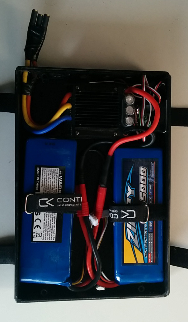

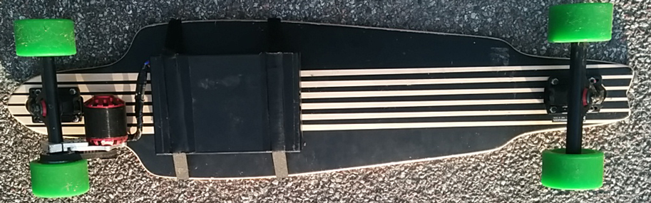

Finally "finished" my setup for now as well, upgraded my deck (bustin boards 36 EQ) and my receiver with @austindavid and @torqueboards wiiceiver kit.
Final specs:
  • Speed: 24 mph
    Distance: 8 miles
    Weight: 17 lbs
    Motor: Single Turnigy SK3 - 6364-245kv
    ESC: Mamba Monster 2
    Battery: 6S 8Ah string
Remote: Wii Nunchuck Wiiceiver (via http://diyelectricskateboard.com/product-category/wireless-wii-nunchuck/)
Almost forgot to post the final result here. Here are some images:
Close-up of the electronics box
