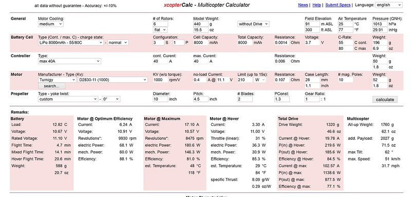

So, I put some numbers in the eCalc website and came up with some disparate results, perhaps.
Since you are a pro, Nechaus, please look over this for me, if you have the time.
I ran this twice, once with the 3530, and the second with the 2830. Do you see the huge difference in run time? (20 min vs 13.7 min)
Also, the payload is not that much lower with the 2830....
Am I missing something??

That is probably right, I dunno man, Its upto you. Its more of a personal preference with me choosing the 3530 1100kv, I just like them for the abuse i have given them.. I just had bad experiences with the smaller ones, I reckon 1000kv 35xx size wouild be good, but up to you, either way you go, its a hex so it will perform well. not to mention there is a bit of a price difference i believe last time i checked, your probably better getting the 28xx and save some money, worst case you break one you can revert back to a quad.. :D
