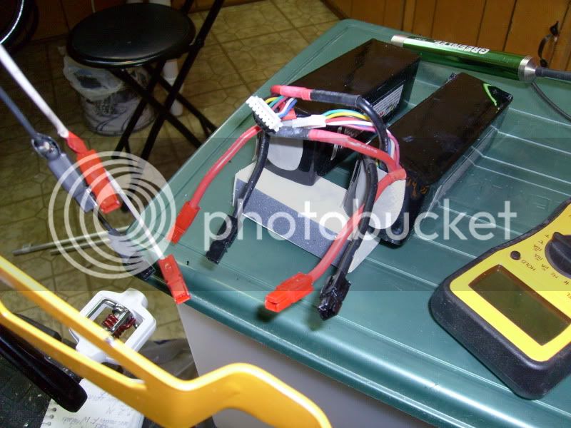

Forgot the LVC, returned to using 12S :!: what have I done :?: ; switched the polarity; the motor is still lifeless yet a whitesh or red light in the ESC blinks in a continous manner, color depends on the polarity(no chirp). There is no LED change when going from mid-throttle to zero throttle. Going to look at the ESC to motor Andersons with a magnifier and give 'em another tug test.

Glad you 2 are around, I goofed something simple, not as simple to find my goof :roll: Talked w/ Tom of Castle Creations this am. He indicated that the little orange wire from the HV160 lines up with the white coming from interface but shouldn't hurt if both polarities tried. That the ESC doesn't chirp indicates a signal problem going into the HV160; also, with 2X connectors to motor, there's little chance of there being zero connection yet motor sits lifeless; also there's continuity from batt to above main connector; I'm focusing now on interface/ESC but keeping my ears up for a wiring goofawh.
For 12S. I'm connecting the red lead from 1 Lipo and a black lead from other Lipo. This proved not true!
For power to interface; soldered into main wires & to 2 pin blk-blk, red-red: for ESC signal wht-org, red-red, blk-brwn
The main power wires from the large Andersons bend under 180degree and lead down into ESC.

Ypedal said:
On the battery packs.. what's the black and red loop on the top of each pack ?... ( seems like that would be a dead short... but it can't be or you would have a serious KFF going on there..)
Some time back they (don't know who They are though!) decided to make split battery packs for shipping requirements in some countries. Meaning that a 6s battery would actually be 2-3s batteries to meet shipping their requirements. The jumper connects the 2-3s packs in series to make a single 6s pack. They just added a few grams that were otherwise not needed. If something were to happen then the voltage would only be 11.1 volts in stead of 22.2.
Safety first!!!
Tom
The Venom Lipos have an extra pair of wires to connect to activate: I've cross connectted those to get the 12S. (Believe I observed Dogmanz do this with his pack at Tucson DR **This turns out to be incorrect!.) CA doesn't boot, (Yes! after fully seating the Anderson) I've never used a CA before. I questioned the shunt issue with Ren Bikes, the new female employee handed the issue off to Justin, he thought the CA shunt would handle 90amps briefly, but yes I thought the Standard 45amp shunt was in question.

And . .. the CA boots up showing :shock: 23.9V
Ypedal, progress made. The CA now reads 48.1V. The HV160 started with a red blink then went to off-whitesh. Had throttle set half way at power up, went to zero throttle, tried the throttle back and forth, nothing other than continuous blinking.
OK, tried powering up zero & full throttle. Getting red blinks at full, white blinks at zero. At full it blinks 3-3-2 red, then repeats.
No chirp.
