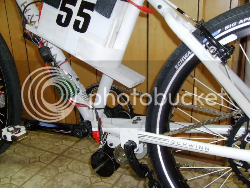

1st foto is the below BB motor mount, ran into space issues and trimmed another half inch from bottom
Wider 15mm pulley has standard 35ft/lb slip clutch. Narrow 9mm pulley has lite duty 12ft/lb slip clutch. I'm prepping a 15mm pulley for the lite duty slip clutch as I don't think the 9mm will hold up, especially to the high temps. 9-10ft/lbs needed for 3.5:1 mid-reduction Astro 3210.

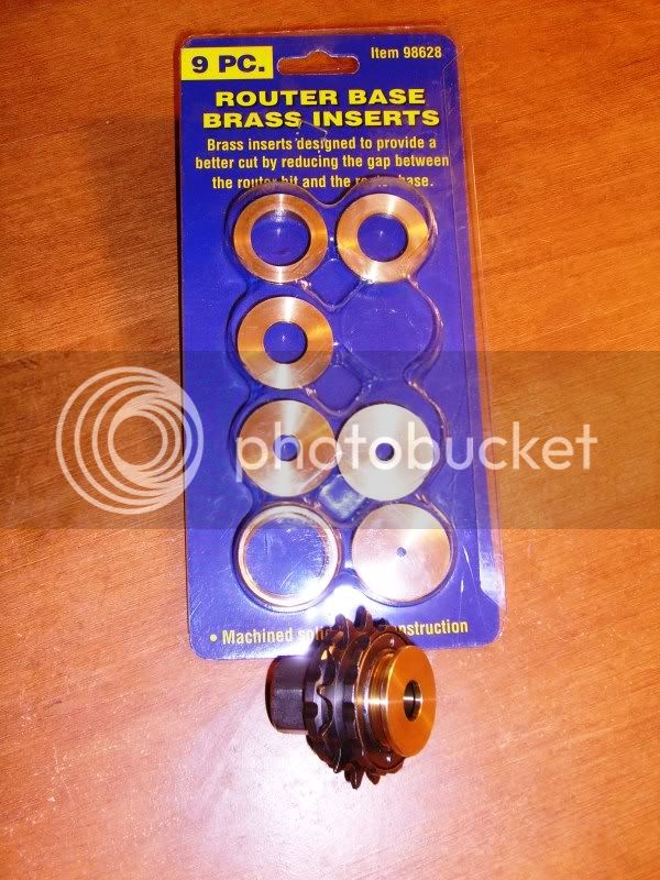

Gave up searching for adapters to support 15tooth and smaller FW's, which I need to have gearing flexibility and to allow a chain path from under the BB. The 16tooth and up FW's use 1.375X24 threads, Matt makes/supplies a niffy adapter for those. Just today found some "Router Base Brass Inserts." $12.99 for a package at Harbor Freight. They have the almost rare M30X1 threads, just wonder if there's a way to convert 'em into FW adapters with 1/2' bore :?: The threads turned out to be M30X1.5" which is close (just means the thread pitch is slightly finer so there is an interference fit). Since they are soft brass and the FreeWheels are hard chromemoly, the threads can be forced. I threaded the inserts in & out of the FW's a couple of times; the threads conformed to a more useable/relaxed fit. All that's needed now is a 1.03"(26mm) diameter by .625" long with .5" bore with #8 set screws aluminum rod which I could press to fit inside the brass insert. Of course, this is just for developmental interest as Matt's box of joy(with micro FW adapter) is on its' way 8)
From lower left to right, FW tool, 13tooth FW with the oddball threads, and brass insert that can be forced to fit.

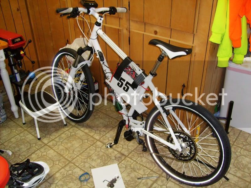

After 12hrs of prep on my drill press, I killed the 15mm wide pulley, so plan 2; took the 9mm pulley and built epoxy edges :p (15mm belt)
Here's my work buddie; the jackshaft grinding is so noisy I put hearing muffs on, yet young Mo-gee hangs in there (he's 8mo old).
Most parts fitting under the BB need modding.
I'll grind another 5mm off the micro FW adapter Matt sent me and relocate the set screw holes inward. I'm able to take the 1&1/4" FW adapters and trim 'em down to 5/8" which is necessary to get the chain line inside the frame. (If the chainline runs outside the frame, the cranks don't allow enough room for the 2 speed. Space is truly precious with the below the BB location.)

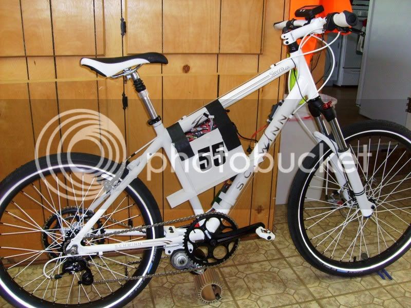

Pretty much rebuilt the 'Toy Racer' The motor is now under the BB with GT3mm drive & mini-slipper clutch, 13T FW. Pretty tight little setup. Just took 'er out for a spin, 1st since Jan, yet observed very high amps being pulled at low speed. The electrics remain HV160 using 12S lipo. The new larger shunt is 100milliVolt-100A or 1.0mOhm.

The chain tensioner, biggest challenge of this build, is 2mm offline. It clacks as every link starts offline then clicks into place. For 1, I'm pleased with the fact that it can be noticeably misaligned and still function. Though it did throw the chain after 3 miles. The slip clutch started pretty loose so by the time I'd adjusted tighter in several small steps, it had had a nice little run in (a break in of sorts that entails getting it hot and the surfaces polished).
Bathroom scale says "53lbs" with just a derailer, and cable to add, gonna come in at sub 55lbs :)
During the 4 mile jaunt twisted the throttle and glimpsed 55amp/29.5mph with a definitive sense of moderate acceleration. Warren may say it's impractical to power wheelie his 3210 recumpent, but I wonder if with lowesh 24mph gearing a regular Mtn style bike wouldn't power wheelie :shock:
Not much downside, I do need to pull off the rear wheel and part of the motor mounting to access an 'L' plate that holds the tensioner. It's doable, I'm into triple time as of now, the grass can grow and the kittens can track dirt into the house, but I'm a man with priorities :!:
Crossing my fingers that the 2 speed shift comes together 1st assembly attempt, Toy Racer would likely make the main race event if I could pull that off 8)
