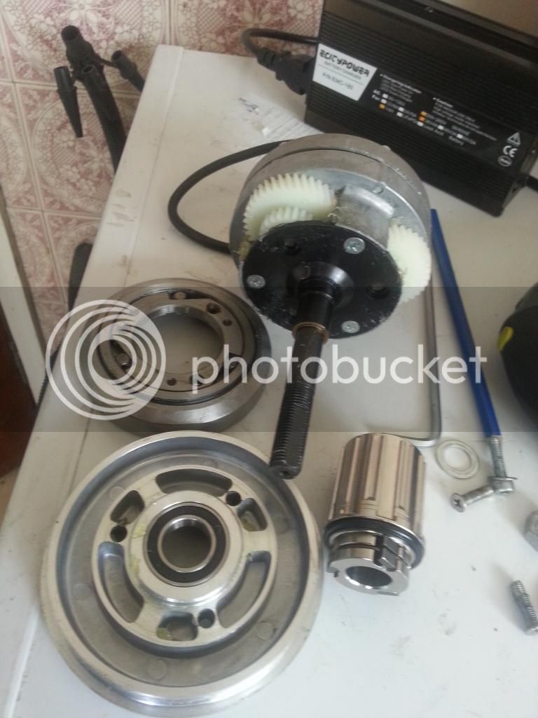

Being a touch lazy here, but still hope Fellow or someone else can help:
Got my springs, there's a chance I'll get at least 2 hours this weekend to try to install them, but as you might note, 2 hours is not a lot of time, and I really need the bike back together by the Monday, so I'm hoping I can get some advice up front to lower the chance that I'll be left with parts of a bike instead of a bike to ride come next week.
Any chance I can get tips on removing and replacing the springs and rollers? I know how to disassemble and reassemble the basic assembly, I have watched how roller clutches work, and it doesn't look too difficult, but I think that always belies the reality of a job.
For example, is the roller held in by any kind of retainer? Is the spring only held in by the roller? Tips for compressing the spring while you replace the roller? Any gotchas that will save me time basically.
Any tips appreciated. Thanls.
It's really simple. You remove the three screws on the outside of the the side-plate and the the three screws that hold the cover plate on the inside. Everything then comes apart. You have to rotate the inner in the forward direction a little bit to unlock the rollers before you can slde the inner from the outer. It might be an idea to do that bit in a box so that you don't lose a roller. Mine was rusty, so I removed one roller at a time before tapping the inner out. Make sure you make a note of which way the ramps point or which side is the outside because the clutch inner can be reassembled either way up. If you get it the wrong way, the clutch will work in the wrong direction - backwards instead of forwards.
It's a bit tricky to get the rollers back in: Put the inner part into the outer without the rollers. Insert a spring, then use a thin blade to compress it fully while you drop in the roller. Repeat for the other two rollers, then reassemble the inner cover plate. It's probably a good idea to use Loctite on those screws.
Here you can see the clutch from the outside after removing it from the side-plate. It's a Q100C, but the clutch is the same:
And here you can see the three screws on the inside that hold the inner cover plate:
Here it is with the inner cover plate removed.
Thanks D8veh. That gives me a lot more confidence to give this a go this weekend.
Cheers.
Okay. I managed to pull it out this weekend, but the bad news is that a 4.0mm spring, won't fit into a 4.0mm hole.
I'm going to see if I can get enough machined off the inside to get the springs to fit.
Can easily see why these don't last long. In the photo below, I really only managed to salvage two springs. The third one was torn to shreds and you can see little bits of it all over the photo.
The larger new spring in the centre is what I intended to replace it with. Not sure if I'm going to have to cut it shorter to fit. Will find out once I machine the holes.
Was the spring broken before you tried to get it out? If, so, that would make your clutch slip, so you don't need stronger springs. I've been thinking about this. The springs only are supposed to put the roller in the right position. The rotation wedges he roller. I don't think stronger springs will help. They could make it worse because they will hold the roller against he ring, which will make it rotate againt the spring. Also it'll cause a lot of drag when freewheeling.
The springs were definitely broken, and the clutch was definitely slipping. But that makes perfect sense to me. The spring appears to hold some tension, pushing the roller against the two surfaces, so that it can lock the clutch, right?
A stronger spring is probably less desirable as you need more reverse force to unlock the clutch, i.e. freewheel it, as you said. However, to get a thicker wire that doesn't get chewed up, thats a trade off, right?
I'm a little confused as to why you think i don't need stronger springs if the clutch is slipping unless all you're saying is get a spring that is not stronger but still more resistant to getting chewed up.
