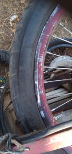

It's taken several years for this to finally fail, though. Here's a pic from 2019 when I laced this motor into this already-damaged rim (didn't have many choices at the time), the damaged area is at the lower left corner of the image, farthest from Jelly's tail.
EDIT:
found the post from when the rim was damaged, February 2018. It's not as bad as it is in the later image, so there must've been some subsequent impact I didn't find a post for (could be there just skipped in my quick skim of the thread for these images). I vaguely recall the event happening but no details, so...

also pic of the worsening rim edge failure.

Is this happened maybe because drive side wasn't tightened by a nut? Seems like being a bit loose in the torque part caused fatique.
Or we should be more afraid the tiny and hollow QR axle ends to snap too. :/
