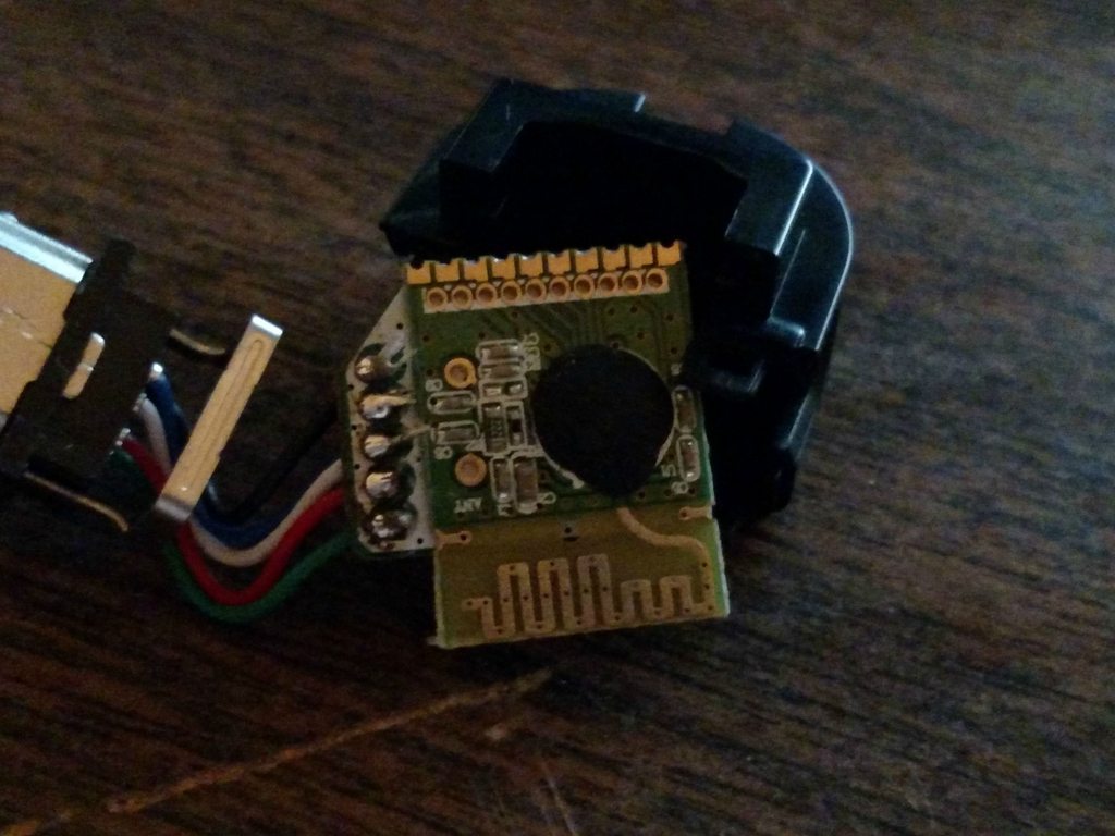

Hello guys,
I need to extend the wiring on my Nyko Kama but I don't know which wires are which (data, clock, power, ground, etc.). Plus I'm colorblind which makes things even worse. My daughter had to tell me which colors these were but I think she's right and not messing with me. So there's black, blue, white, red, and green. See my pic below. Any help assigning these wires for their functions is much appreciated! thanks.
EDIT: after looking at pictures and the layouts on nunchucky and sparkfun adapter it looks like:
1. Black = Ground
2. Blue = Data
3. White = ?? not used? hmmm...
4. Red = VCC (+)
5. Green = Clock
