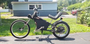

Don't know if she qualifies as a build, a brand new Luna Eclipse is a pretty good startin point, but here's before and after pics.
July 25, fresh outta the box.
Yesterday
before:
after:
bicycle: 1996 Redline PL-24 (24" mid-school BMX)
e-motor: Tongsheng 36v TSDZ2 with alu heatsink plate, temp. sensor and TSDZ2-ESP32 (BLE bluetooth)
display: SW102
battery: 48v/25ah (Samsung cells) in a 3d printed battery case with xt60 (dis)charge ports (battery is fully potted in polyurethane)
throttle: thumb
firmware: TSDZ2-v16 (Mspider65)

Ordered the largest battery which would fit the frame. See https://nl.aliexpress.com/item/32807827024.html
Can't tell anything about the range yet, because i just finished the build, but my intention is to use the bike as my daily commuter (street) and occasional mild trail riding (forest).
