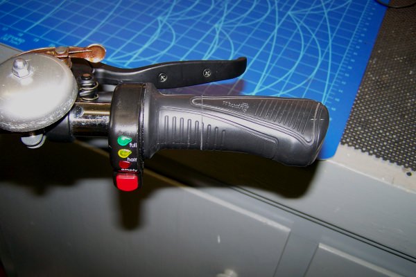

I thought after riding motorcycles that a full twist throttle was surely the way to go. But had issues with the throttle bouncing all over the place on rough terrain. As well as not being able to get comfortable, and relax with my hand on the throttle grip side. I'm thinking that it must have something to do with the firm resistance that a true motorcycle throttle will give you. As apposed to the some what plasticky and extremely light action of a hall sensor type. And after an almost disastrous episode letting someone not too familiar with a twist grip ride my bike. (panicked and could not let loose after twisting, thank goodness for E-brakes!) Something had to change. I thought about resistance or adding mass to slow it down. But came to the same conclusion as John... cut it down. (at least to try it)
Works great! I also have cruise which is terrific also... just slide your hand a bit more out on the bar or relax your grip and RELAX with some weight forward.
This is all smooth bike trails mind you, no mountain biking here.

If I had proportional regeneration... (next builds wish list) I would endeavor to put both hall sensors in the same throttle grip. Or at least controlled by the same throttle. With a detent stop in the middle between each range. And spring return action for both back to it.(the off or detent position) With the action being, off or detent...pull back for throttle, release...detent... push forward for braking... release... back to off or detent.

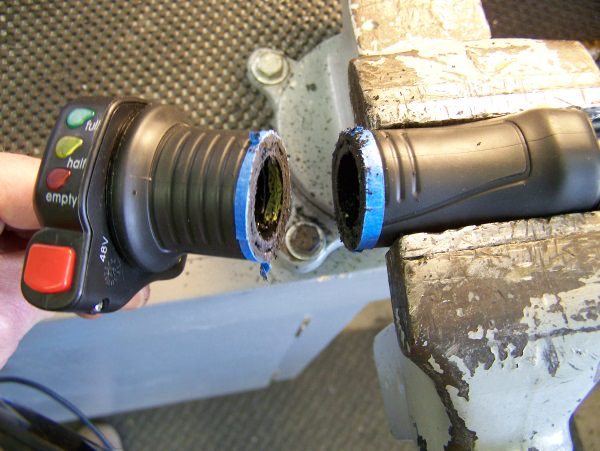

TC,
What did you use to glue that stub end back on the bar? I've had them slip before, and on the last full twist I used the entire tube broke and slipped off the end leaving me holding only the left bar with an empty tube in my right hand as my rear wheel went thru the gutter entering the street with oncoming traffic in both directions. How I managed not to eat some asphalt I don't know, but that's when I decided half grips only and allen bolt clamping grip on the end.

Hi John,
To make up the difference of the slightly larger ID of the cut off throttle handle, I just nicely wrapped electrical black tape in two places with enough layers to have it fit VERY snuggly (much like a left grip...) The downside is that you have to remove and replace if you want to remove the throttle...
Pretty snug can work as long as you're the only one touching the ebike, but be conscious of and alert for the non-twisting part pushing against the twisting part and preventing the throttle from going to zero. I had this happen to me about 9 years ago after dropping an ebike on its right side. My 6yo son had to come to the rescue. Picture someone off their bike and it starts to go while they have one hand on the handlebar. As the motor starts to spin faster and faster he's trying to keep the rear wheel from touching the ground, but the angles prevent him from keeping the wheel off the ground at first, so he's spinning in a circle with the bike going around with a heavy rear DD hub skipping off the carport tile as it begins spinning faster and faster before he finally gets the bike under enough control to keep the wheel off the ground for someone to come help by turning off the key. That was the most memorable time, but before going to allen bolt clamping grips I've had that rubber non-twisting part move enough left to cause issues on more than one other occasion.

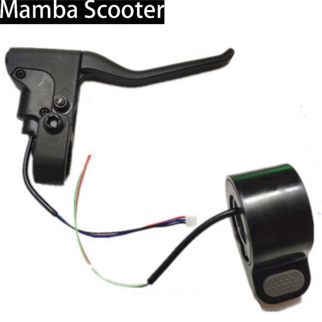

Just came across this whilst perusing ali.
https://www.aliexpress.com/item/32900195401.html
I wonder if that brake lever would work for variable regen... Or as a throttle for that matter.

Yes, that should work as either a throttle or variable brake. Mounting it along with a normal brake lever might be the challenge.
