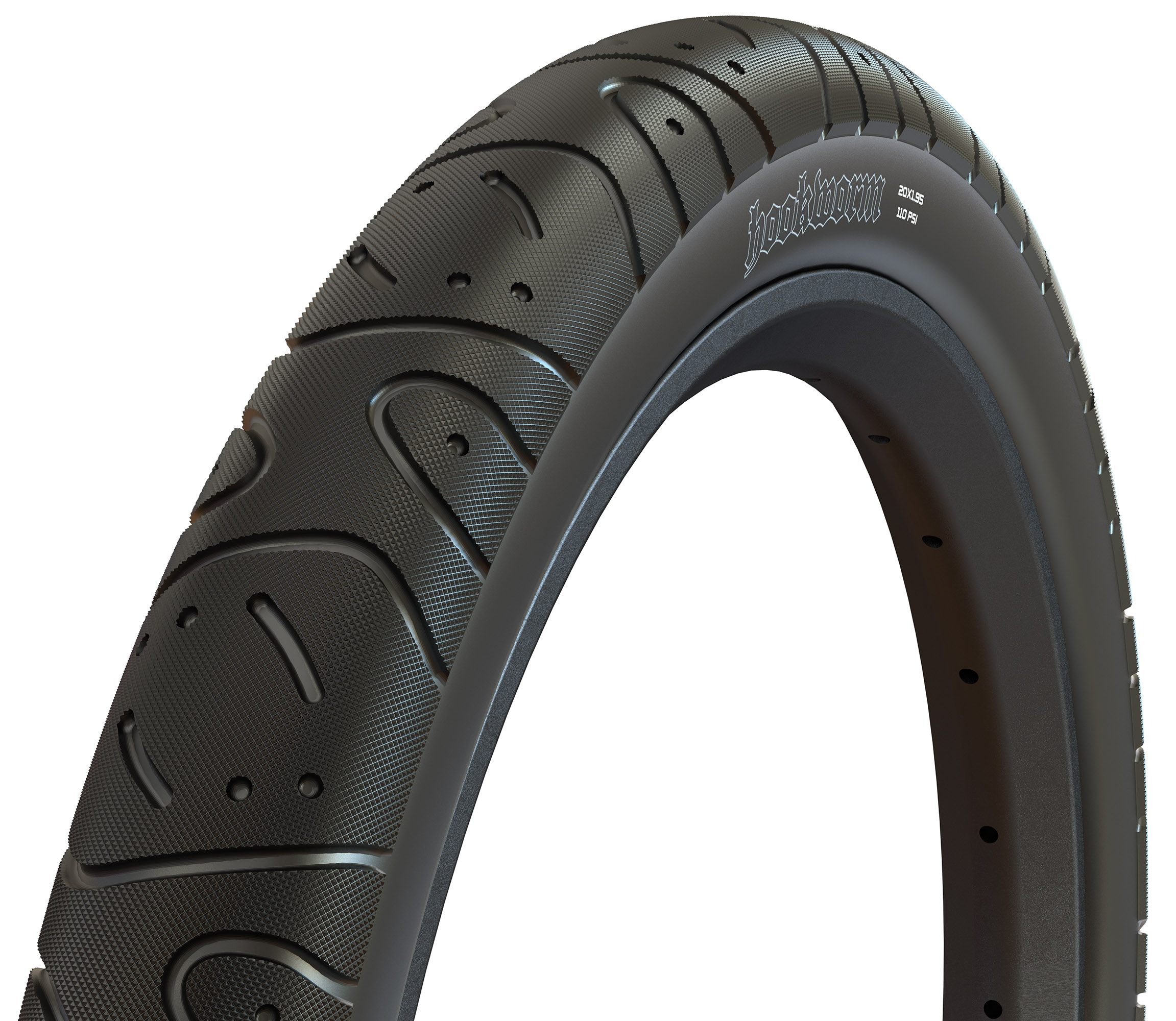

You simply buy bad tyres. Rubber is paper thin. No puncture protection. Too flat tread.
The Maxxis Hookworm 26 x 2.5" is a thick, tough tire with tread rubber wrapped all around the sidewalls. It weighs 1250g and is a favorite of city pedicab drivers for its sturdiness and all-around puncture protection. It doesn't have any supplementary armor belts, just thick tread and a thick casing.
Extra tread features mean more thin spots that are easier to poke through, and more places for foreign objects to be captured and held in the tread for repeat attempts to puncture. Also the more tread features, the more noise and rolling resistance. So I prefer as smooth a tread as I can get for any given size and thickness of tire.

I'm guessing you didn't see, or didn't remember, my earlier post about a puncture in a Continental Ride City tire that has the same construction and the same built-in protection as what you're using. I got that puncture the first time I rode home from work on it.
No tire is invulnerable to puncture. That 3mm thick metal plate that caused my latest flat could easily have flatted a car tire.

The part of the tire that was cut is thicker than the sidewall of your tire, believe me. The largest size of Continental Ride Tour for 26" wheels weighs about 400g less than this Maxxis Hookworm. Tire sidewalls are usually quite thin, but the Maxxis Hookworm is an exception. Please know what you're talking about before you spread misinformation.
I had hookworms, and in my opinion, they were a slightly above average tire, puncture protection wise.
You get more rubber, and harder rubber with something like a Schwalbe Marathon Plus.
I don't think the best bike tire on the market would resist that flat though.
