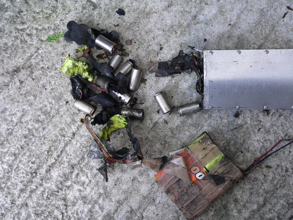

Charge termination is VERY tricky on NiMH. I've seen many a melted pack :mrgreen:

My first ebike battery pack was a 36V, 7.4Ah NiMH pack, made from RC sub-C packs. One night the charger had a problem and I was woken up by a loud explosion in my study at around 4am. I managed to drag the exploding pack out of the house and chuck it on the drive, in time for a firework display as another dozen or so cells caught fire and exploded:
This happened on a trickle charge at just 200mA.....................
In my view NiMH cells are every bit as dodgy as LiPo, but they do perform well and last a long time.

It is because of this forum's wisdom that I'm putting my cheap used (but still strong) NiMHs in 1000 degree fiberglass sleeves. I believe that when they go, they get hot enough to melt the plastic shrink wrap, which could short out adjacent cells and cause a chain reaction. Since I've got a kWH of cells that are capable of very high currents (Panasonic gives curves out to 20C) that could be quite a fire. Fusing may not do any good unless very carefully done so I'm going to back it up.
This sleeving looks good for D-cells, I'll know better when it arrives:
http://www.mcmaster.com/#catalog/117/803/=b6s11f
Then of course the whole pack goes in a metal box with fire-resistant padding and maybe only charge the thing in the middle of the concrete floor.
