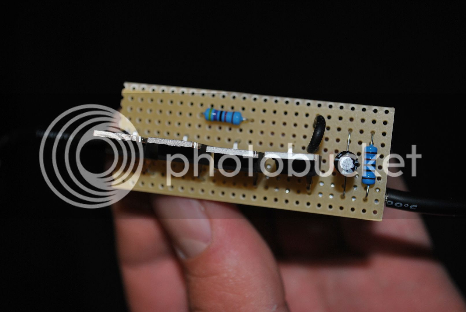

There must have been a short somewhere for them to blow. The FETs are protected from the 84v by the 47K resistor, so there's no way you can get enough power to blow anything. Were the battery wires connected to anything?
Try again, but with only one FET at first. Test it with nothing connected to the main wires. You can check it with your meter measuring resistance between the two main wires. You should see the resistance change from very high to zero. It'll give enough current for a gentle no-load test on your bike. When it works, add the other three.
Looking at the photo, you used two 47K resistors instead of 47K and 10K, but that only makes it switch off more slowly. What was the voltage rating of the capacitor. You need 100v.

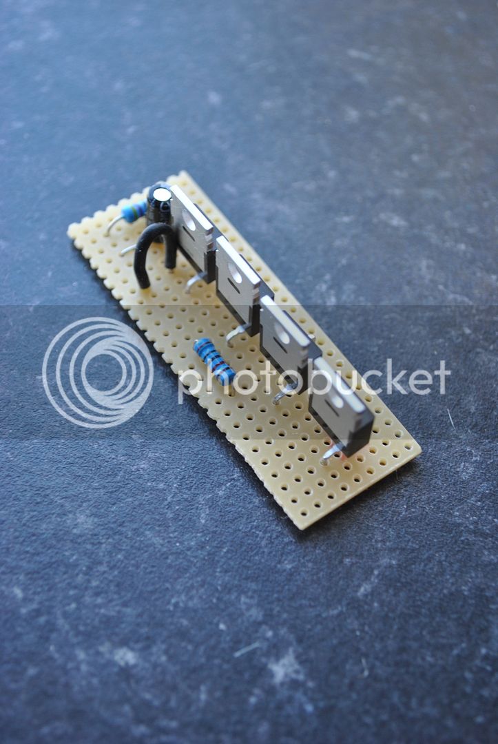

Here is another board I built straight after making the first one. Its probable a bit clearer to see if there are any faults.
Red battery wire went straight to the controller, black battery wire passed through the board to the controller.
It is a 100v cap, with the negative leg on the negative track.

The FET gate is rated for about 20v maximum. You want it to be at 10-15v to get full turn on.
If you're using two resistors of the same value, the gate will be getting half the supply voltage (poof!)
In my version, there is a zener diode that prevents the gate from going over 12v.

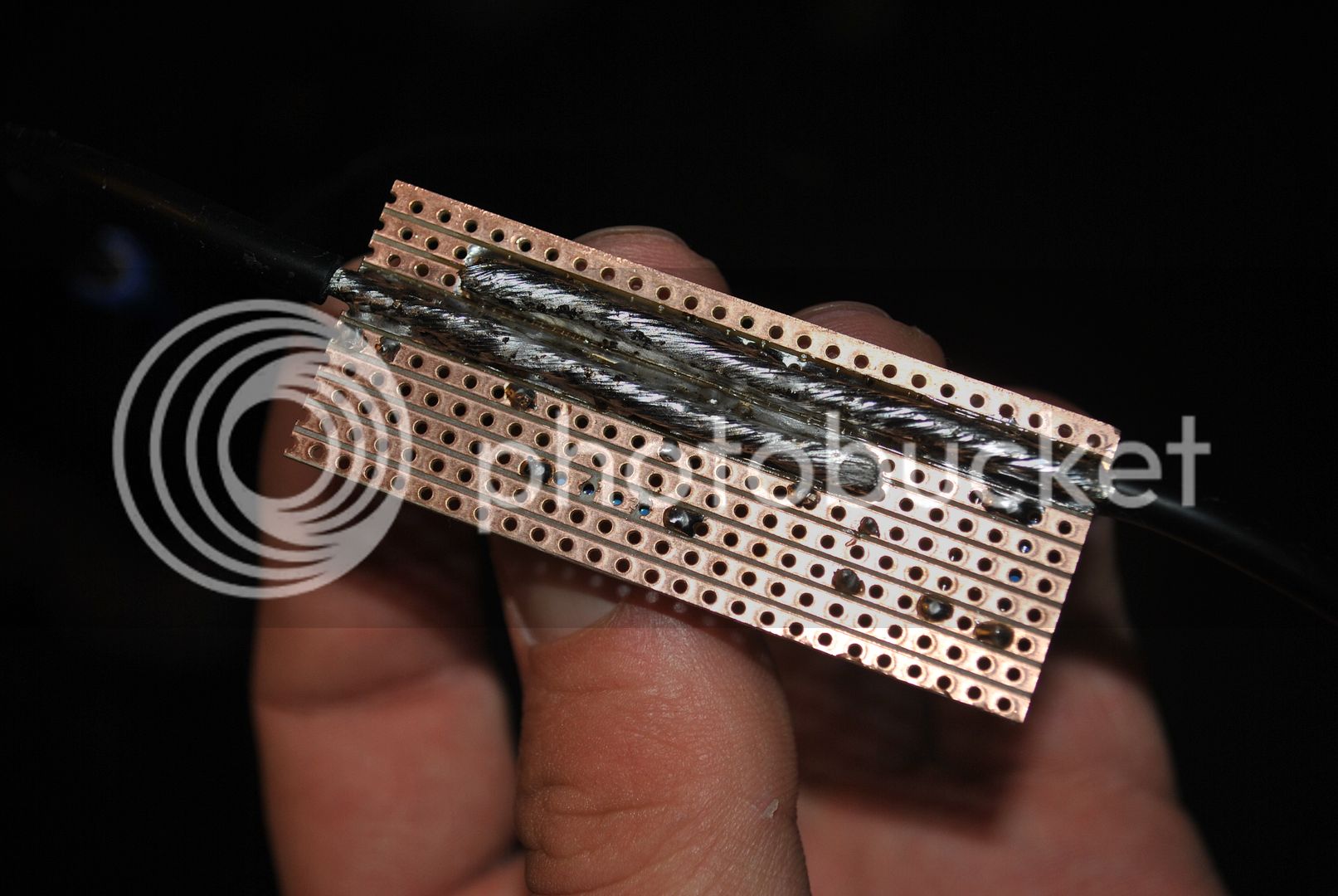

This board has two significant fabrication problems:
  1. Uncut trace as pointed out on the previous page. This is applying pack voltage to the FET gates - instant death.
    (Either cut the trace of jog the resistor at an angle to pick up a second trace.)

    resistor r1 doing nothing, no cut track
  2. Bad resistor value
    No. That is not how this circuit works. This is a significant issue because this circuit attempts to be 'parts thrifty' by using that resistor to set the max gate voltage. As a result, the R1/R2 ratio is critical. Using two equal resistors raises the gate voltage to 1/2 pack voltage (40+V in your case) and bye-bye FETs...
    On the previous page fechter recommended using the 'improved' circuit which adds a zener specifically to address this problem.
I mentioned the non-polarized cap because I assumed you were using the later 'good circuit' (I couldn't make out the tiny linked circuit image when viewed on a tablet). I've posted it below. Apologies for any confusion there - assumption at work! - My Bad.
EDIT - oops - fechter sneaked in a post before me saying the same...
As said- R1 is missing.
So why isn't the track cut under R1? Both ends are connected to the same track meaning it is doing nothing- it's not there.

Just made another one, and cut the track on this one, along with the correct resistors.
Connected it all up, and all seemed good (bike wasnt turned on), flicked the switch to power up the bike and the fets blew. :shock:
OK, you solved the wiring problem at least.
I strongly suggest using the other circuit I mentioned on page 6. With your circuit I can almost guarantee FET failures when the controller is connected. You could go through a lot of expensive FETs.
Well - as discussed in the thread and as fechter told you a few posts back - even when built correctly - this circuit eats FETs.
You can read the thread yourself, but the gist is that your circuit drives the FETs with a non-linear current curve that slams the FETs hard immediately on power-up followed by the current tapering off. Fechter's circuit instead has a very moderate fixed current for the whole pre-charge period -- making for happy FETs.
The surge in your circuit is related to the controller capacitance so the same circuit may work on one bike but not another (translation: "Well, it worked for me!" doesn't mean it will work for you - or that if it implodes that you built it wrong or had defective parts - it's just its nature...)

Measure the resistance from the positive connection point to the gate rail. It must still be shorted.
