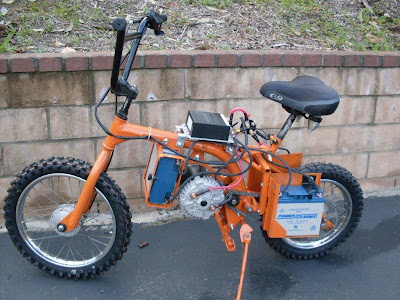

While I am wasting time I might aswell search:
Similar ideas...
