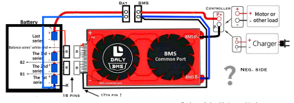

BMS finally arrived in the mail, went for the 100A unit to cover future needs, but wasn't quite ready for the wire size. :shock:
The mounting placement will be in back, next to the battery box wires, and the old 40A controller is getting shelved. I need to make the mounting plate for the BMS yet.
Depends on how much room there is, but it would be nice to use two 8 pin Deutsch connectors for the balance wires, the BMS has 17 pins. So I probably need an 8 pin and a 12 pin. (Deutsch doesn't make a 9,10,11)
One thought was to run the 17th negative pin along with the Neg. battery wire, so I can use the two smaller 8 pin connectors. :?:
Anybody know if this is taboo?
Modified circuit;
I think you could get away with it. Voltage monitoring of cell group 1 might a bit off under load, but I bet not much. Not sure if noise from the FETs switching would affect it much.
What nags me is why they even have two negatives in the first place, if they both go to the same place. I can see where there
might be a problem, (in this situation), where the battery is disconnected first and the balance wires are still connected without
a negative.
Well, probably best not to mess with the unknown with so much at stake, just curious. I'll buy some connectors and see what kind
of room I have to work with first. There are other smaller connectors too,.. I don't plan to remove the battery that often.
There's still the possibility of going without the connectors at all, as a sort of dongle, which I don't like much but should explore yet.
The current plan is to make the BMS base plate attach magnetically to the frame, so it can be removed easily for the connections or whatever.
I need to get some of this stuff worked out before I can start soldering up the wires,.. so steady as she goes.
That looks like it should work OK. One thing you want to avoid is allowing a condition where the main B+ and B- are applied to the BMS without the balance wires connected. Since you have the B+ connection only on the balance connector, you should be safe. Unplug the + side balance connector first and plug it in last. This will prevent applying half pack voltage to the lower half of the BMS.
All this may not matter depending on how the BMS is designed, but I've had several failures caused by not connecting the BMS in the right sequence.
What can happen is when you apply voltage to a large section of BMS without the balance wires attached, the voltages may not divide perfectly evenly. This can cause one cell to go high enough to trigger the balance shunt. Once this turns on, the remaining channels will see overvoltage and start turning their balance shunts on. The last channel to turn on may have way more voltage across it than the rating of the parts and fail. Usually the FET that switches on the balance resistor fails and shorts, causing that cell to drain constantly, which can damage the pack.
