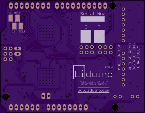

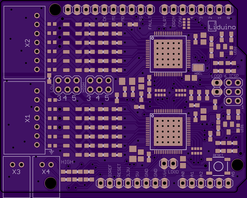

Hi everyone,
I just want to point out that I am still working on my own board utilizing the BQ76PL536A and this thread is to discuss this board. I am not collaborating on hardware with dmwahl and mwkeefer, because I have a slightly different vision for my board, but we have shared software. I think their board is great and has the benefit of being stackable, but I'm developing mine more for the average ebike user with a 36 or 48 volt pack.
The shield that I made works and is functional, but the first spin of the board left off an important capacitor and improperly routed the CS signal. This is why I wasn't able to provide any boards to those who requested them.
In the next few weeks I will be working on layout for a shield compatible with the Arduino Uno rather than the Arduino Mega, because it's obvious that most people use the Uno. I will make a rev2 of the Mega board when I finish the Uno board.
Hopefully I will have a board ready for beta test with select forum members at the end of this month. I will include several new cool features at were left off the first iteration, and if you have any suggestions, feel free to leave them here and I may be able to include them.
The one thing I am not flexible with is the number of BQ chips per board. The Uno will have 2 chips (supporting up to 12S), but I might be able to squeeze a third chip on the mega board (supporting up to 18S). Also, due to liability concerns, I will not be supporting FET discharge and balancing on the board. The shield will be for gathering voltage data, and will not be used for charging batteries. Sorry!
Some of the features I'm optioning:
- Fused cell inputs to prevent shorting between cells
- LED indicator lights for FAULT and ALERT signals
- You can choose the CS pin used on the board (for example, set it to pin 6, 7, or 8)
- XH input connectors to minimize exposed metal
- Supports between 3 and 6 cells per chip
- Ability to reprogram EEPROM through Arduino
- Ability to leave board plugged into batteries while not in use

Update for 8/20:
Spent the last week routing the new board, the traces are a lot tighter with the new components and smaller board size. The board is about 90% routed, so I still think this will be possible. I am moving the EPROM programming functions to a separate small board so I can reprogram chips for anyone who doesn't like the default settings. This will lower the BOM cost per board, and component area.
I am trying to gauge interest, and although this thread has a lot of views, it would be helpful to let me know if you're thinking about purchasing a board when they become available. I am looking at the final price to be between $100 and $120 shipped, realistically available about two months from now.
Please let me know if you would like some other features and I will see what is feasible. Thanks for reading!
