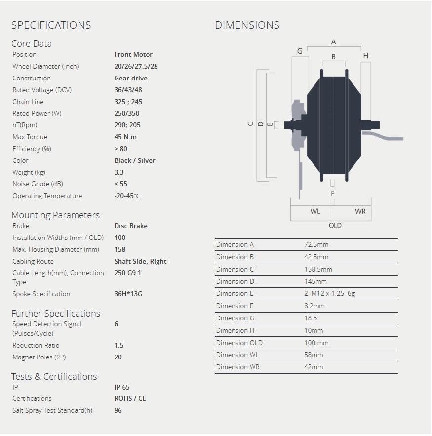

Hi, anybody know the number of poles and gear reduction on a g020 250w hub motor also the number of magnets for the speed sensor? Cheers
Google results:
20 magnet poles
5:1 ratio
6 magnets for speed sensor
On a KT controller
P1 = 100
P2 = 6

I red somewhere 20 poles and reduction 1:5 so I put P1=100
But I find that the motor don't run as smoothly as my old Q100
For the speed magnets, I put P2 = 6

G020 has same number of pole magnets, speed magnets and same gear ratio as the G060
The screws need a whack with an impact driver just to break them free. If you use a normal screwdriver the heads tend to get ruined and you end up having to drill them out.
G020 250w, 350w, 500w are all the same, just a different label/engraving for different markets.
