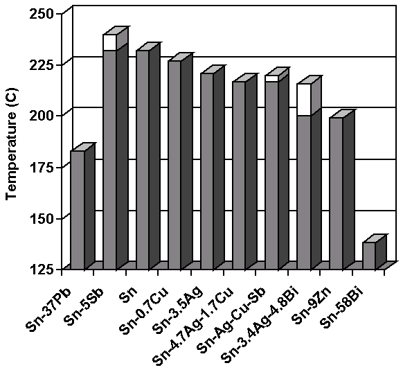

Great advise about the iron of course, but I'm afraid you're mistaken about the choice in solder. Proper lead/tin solder melts around 183C, and has superior surface wetting properties than SnAg lead free blends melting around 218-230C, and higher surface tension to resist wetting. ;)

If it works, hey, it works. But I don't understand what is to debate, or who full-throttle is? Melting points for each different alloy blend of solder is widely available, and a consistent non-debatable characteristic of a given alloy. It would be like debating the temp ice melts, it's a pretty well researched and tested attribute. ;)
Notice the leaded solder on the far left. :) Notice the lead-free stuff and silver stuff in the middle, and only the exotic bismuth solder on the far right is able to beat lead solder. :) Surface tension attributes are equally well documented, but I'm going to just leave the discussion as it sits. :)

The solder in question was 95.5% Tin, 4% Silver and 0.5% Copper

95.5Sn, 4Ag, 0.5Cu melts at 217degC. :)
