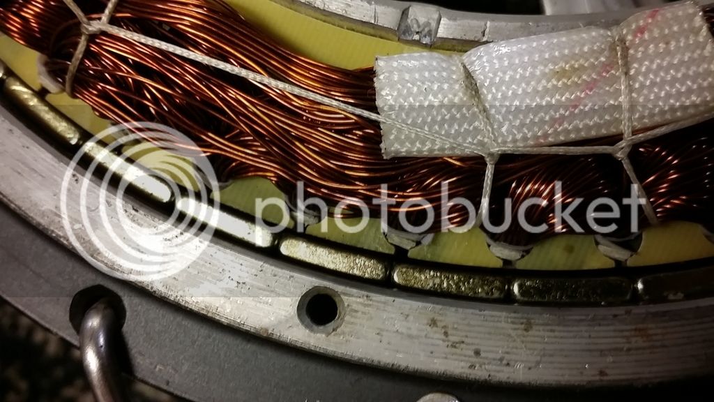

Did my first testing of a small piece of silicone that will be used as an air duct to control the flow of air in the hub motor. Placed a little bit on the motor to see how well it will stick. The silicone holds on very strong, I would really have to pull hard to rip it off, even on the windings
The big piece of silicone is to seal to the motor side cover and stop the air from circulating inside the motor, it allows fresh air in and hot air exhausted out.
What is modified compared to my last cooling setup, is the following. I will put silicone on the center of the windings to stop the air flow from flowing above the windings like it has in my Cromotor. The space was so large above the windings on the cromotor, as large as a finger, and the air would just flow on top instead of through the windings.
The silicone is just placed on the top and not pushed into the windings so it should not impact the air flow through the windings. It will seal against the motor case above it, forcing all air below it and through the hot copper windings.
It should increase the air cooling by a lot. This may also make the airflow more turbulent at that location to also better cool the windings.

Offroader, is that second silicon ring on top of the copper windings really necessary? Is that to make sure that the air is guided between the stator teeth and the magnets perhaps? Anyway, good work and I really like the idea of your air cooling mod.
Thanks for the responses.
The second silicone ring was to push more of the airflow through the windings. What happens is that most of the air comes through the stator/magnet gap and will directly flow right to the exhaust air holes in a nice direct path, probably mostly blowing above the windings.
This silicone ring will force that air downwards, into the windings,. The issue here was that I thought the gap between windings and side cover was larger so I used too much silicone and it came wider than I wanted it to, covering more of the windings. I tried to cut away as much excess as I could, but wish it was not as wide to cover less of the windings. I don't think it matters all that much as the the air flow will hit most of the windings under the silicone.
I was planning to do the other side of the windings also, but I'm not sure if I should or it is worth it. I have to be more careful because of the way the air flows on the other side. The silicone would have to be placed on the very outside of the windings and care has to used to make sure I don't block any holes where the windings to through the stator.
A good amount of airflow does get blown through the stator where the windings are. While not as much as through the stator / magnet gap, it still gets a good flow. In the picture below you can see that plastic is wrapped around the windings. There is a lot of air gaps around this, the air will blow through here.
The fan puts a lot of pressure through all these areas and the air is forced through at a decent speed through all those gaps.
With one side cover off and the stator pressed against once side blocking the stator/magnet gap, I can feel the strong air flow coming through those stator winding holes.
