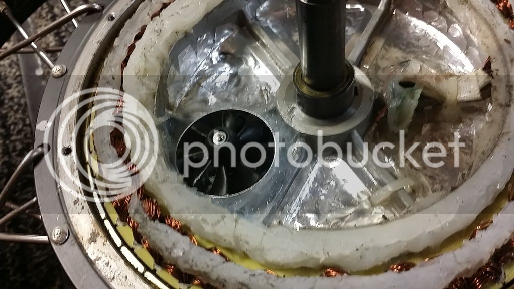

I'm running into issues with my 35 mm EDF fan. Basically the plastic is failing. My first 35mm edf had the impellar break off.
The 2nd 35mm edf had the two of the three plastic arms that hold motor in place break.
The 3rd 35mm edf had the plastic that holds the bearing break.
I'm out $25 dollars each on those three EDF, so total $75.
I find this odd because I went two seasons with a 30mm EDF in my cromotor that is still working fine.
I assume the heat and possibly the slightly heavier EDF motor may be weakening the plastic on the bigger 35MM EDF. Although I am not running it at a very fast speed.
I won't be buying another 35mm EDF, although I liked these because they were a lower KV and I could run them at 12 volts with lower amps.
I was actually tempted to scrap this whole fan cooling and use FF after my 3rd one broke as I had enough of dealing with three broken EDF fans. However, after having to ride less than a mile back to my house with no fan, the motor was overheating so badly even though I was riding slowly. I realized just how much heat my motor is throwing off and how these tiny fans run at 25% speed keeps the motor cool. I am convinced that ferro fluid and heat sinks can not deal with this kind of heat for the type of riding conditions I ride in. I'm constantly pushing 7,000 watts and always fully on the throttle. Many times I'm peaking at 105C+ on hill climbs and I'd rather have the air flow blowing directly on the windings. Basically the EDF cooling works and it is hard to try something that has questionable performance. Although if the FF + Heatsinks worked as well or better, I'd be much better off just using that instead of a fan.
I think I found a solution. A 40 mm aluminum EDF. This thing is totally amazing and it is only $25 dollars also. It does weigh more at 63 grams where the 35mm was about 18 grams, but this thing is all around better. It also is 8000 KV instead of 6000 KV, since I run it at lower throttle it may be a bit harder on my ESC, but I oversize the ESC and they are cheap enough to replace. I have already got two seasons with my current ESC run constantly at about 25% throttle.

Updates on my 40mm aluminum EDF. Finally got around to Silicone it in. This thing is a beast of an EDF in every way. It is ridiculously more powerful than my old 35mm edf. Pulls so much air at much less power and speed. It is built very strong with an aluminum construction instead of the cheap plastic that fell apart in my 35mm EDF. It also is extremely smooth as it is balanced at factory.
It just fit in also, both width and height just fit with not much more room to spare. The motor is very large.
What still seems crazy is this cost $25 while that cheap plastic one that fell apart in 2 hours cost $25 also.
I should have no issues turning this one up at a maximum of 25 amps at 12 volts if I needed a quick cooldown and this wouldn't fall apart. Most of the time it will be run about 1 or 2 amps as 12 volts, which is lots of air flow.

Silicone makes a very strong bond. It would never come loose. However, if I had to remove the fan I could do so also.
Here is a video of my 40mm EDF aluminum fan running at different throttle speeds. I can only go about 1/4th throttle because my power supply is only limited to about 8 amps as 12 volts.
This thing is really powerful and can run really silent at lower speeds yet still move a lot of air. At high throttle the noise does pick up but it will blow an extreme amount of air. I can feel the air flow coming out the sealed bearing on the other side.
This aluminum EDF is really high quality and runs really smooth, it is balanced at the factory. Much better than those cheap plastic EDF ones. Although I used a 30mm plastic EDF for two riding seasons in my cromotor and it has yet given me any issue. The 35mm ones broke in two rides, all three of them I purchased. I believe this is because the 35mm EDF uses a larger motor and the plastic isn't strong enough.
Hopefully this 40mm EDF with its aluminum construction will last a real long time. It only costs $25 dollars as much as the cheap plastic ones so if it breaks after a few years not a big deal. It is easily serviceable also and can be taken apart, it isn't glued together like the plastic ones. The plastic ones glue the bearing and it can't be changed.

It is only siliconed. However, it would never come loose. I can remove it, but it takes a lot of work to peel it out of the silicone. You would be surprised how well silicone sticks to plastics and aluminum.
I bet I could put 30KG+ of weight on it and it wouldn't push the fan out.
