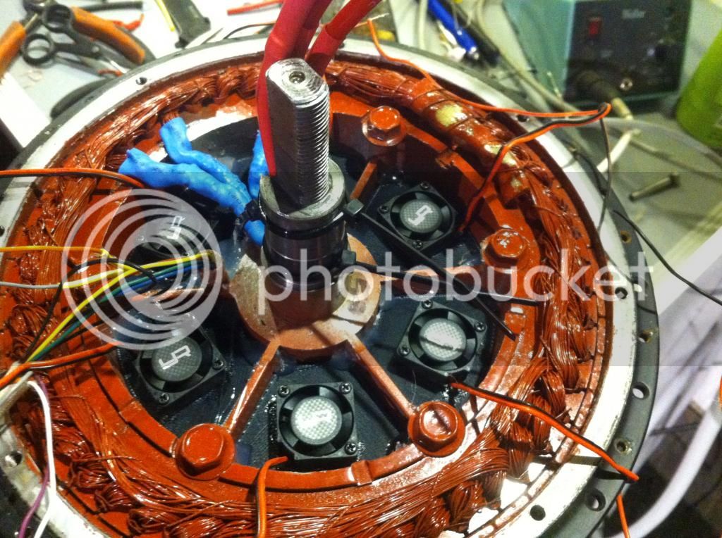

I´m kind of looking forward to what these little bastards can do for the cooling in my V2 Cromotor :D
They blow crazy amounts of air on 7V each (7,2V max), makes lots of noise also but hey...

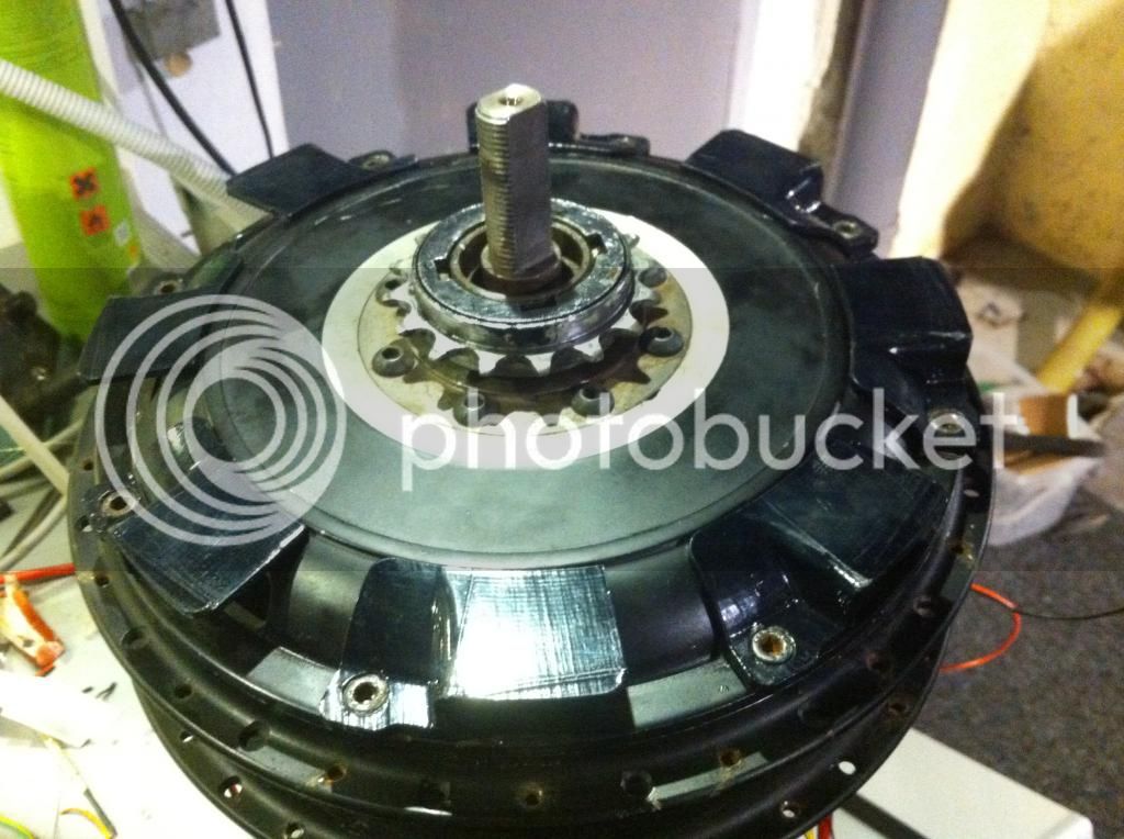

3D-printed inlays for the pockets in the stator, and just some hot glue here and there.

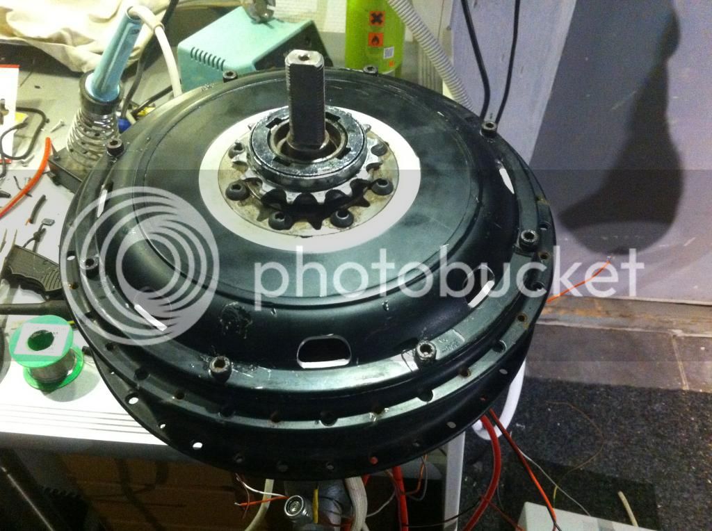

I have hit 120C a couple of times when riding in the woods, slow, up steep hills and with 8-10kW of power. Bike is 55kg with an additional 95kg of me on it.
The windings are sprayed with a special paint made for electric motors "Ultimeg 2000/372" reads on the can. It has something like 30kV/mm resistance and withstands 150-160C.
This coating has been on there 200km with vented side covers.

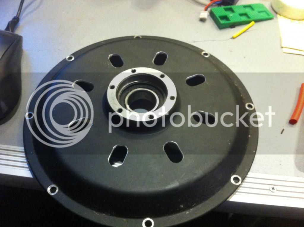

The covers are milled as follows, and I intend to use fan blades on the exhaust side for extra suction.
good job Peter and very well milled intake and outtake holes, but you will also have almost no airflow through the windings and stator teeth where the surface is the biggest and also the heat is generated. you could achieve this if you have intake and outtake at the same side with an AIRDUCT between.
Are you saying you would need the holes drilled only on one side? How would you position an airduct exactly? Do you have any links or pictures of this solution?
