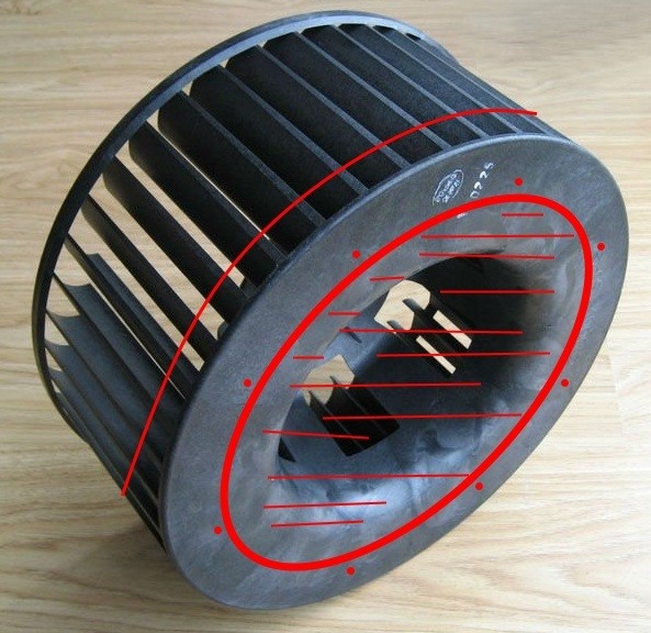

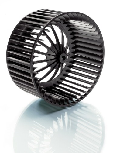

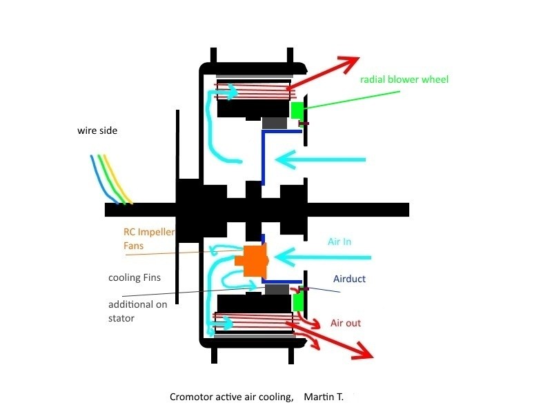

new sketch with radial blower wheel (green part) inside the motor bolted to the sidecover:
With a bit of luck we should be able to find a buyable blower wheel which fits good.
the red lines show how i imagine the wheel must be modificated to make it fit. I hope you can follow :)
I'm having a hard time seeing how the radial blower will help in that location.
Wouldn't it make more sense to put it on the other side, at least when you don't have the fans running it will be sucking cool air through?
For interior blades my thought has been to push air away from the side covers at the stator. I doubt they move much air, but instead help ensure the air inside is spinning at near wheel rpm, make it difficult to take the easy route and flow along the smooth cover, and last but not least pass within a millimeter or 2 of the stator and end windings to create more velocity and turbulence there where it will do the most good. Nice and simple to make and bend, then a little epoxy and a nut and bolt to ensure they can't move or break loose and destroy the motor by damaging the copper. Here are some I've done.

Sure you have right, but on this side there are phase and hall sensor wires passing the stator and i guess it will not be easy to ensure the blower wheel does not chafe against them.
It still will suck air through the motor, but not much through the windings or stator theeth. The biggest part will flow through the cooling fins on the stator and over end turns on exhaust side. Best would be radial blower wheels on both sides :)

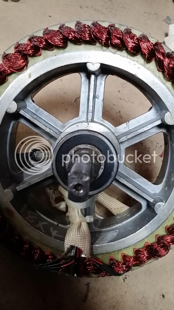

Well it's only fair that I also post about the down sides of this mod.
Yesterday I was attempting to do that real world testing I've been promising, and my motor died.
I had noticed a decent amount of dirt/ sludge build up on the windings. I would say this is primarily from the fans sucking in dirty air as it's worse on the intake side.
I attempted to clean the windings by jamming a soft wet wipe into one of my vent holes up against the windings, then rotating the motor so as to forcefully wipe off the dirt.
It seemed to work, and the wipe came out with a bunch of dirt on it from both sides of the motor. What I didn't realize was that in doing so, it had snagged and ripped a bunch of copper strands off one of my phases, leaving only a few hanging on.
So I went for a ride (to do my testing as above). The motor worked fine at low power...but after stopping on a hill, then dumping full power (4000W) into the motor to get going up the hill, the remaining few strands on the one phase couldn't take it and blew apart taking some other windings with it. The phase wires then rested on the windings creating a weak short...needless to say, the ride home (5+km) was painful!
Anyway, the pictures below show the dirt build up, and damage.
I think I may be able to salvage this motor...again! Today I'm going to clean it up, and attempt to drop some solder onto the phase wire stubs, then reconnect that phase. I'll have to put some insulation (probably silicone rubber wrap) up against the nearby windings so it doesn't short. Ill also have to reconnect the damaged windings that are separated now. If it works, hopefully I'll be back in business soon. :) This motor is turning into a bit of a Frankenstein motor...but who cares as long as it still works. I probably shouldn't put as much power through it if I get it working again though. I would say no more than 2500w (50A) should ensure it doesn't die again.
Cheers
Well that didn't work out as I was hoping.
Turns out the phase was somehow internally shorted to the stator. I thought the phase might have ripped off in between the laminations, so I managed to pull it through to the other side, but the short is still there. I can't see anyway of pinpointing it further at this stage.
I think this motor is now toast. :( :cry: :cry:

I am trying to determine what fan configuration to use in my cromotor.
I can fit up to 30mm fans in my cromotor, and have room for 6 of them.
I will use one slot for a high speed blower, but I want to fill some of the other spots with fans to have some options when driving.
I may use some quiet 30mm fans for when I want silent operation but want some airflow going.
What fan configurations would you recommend?
