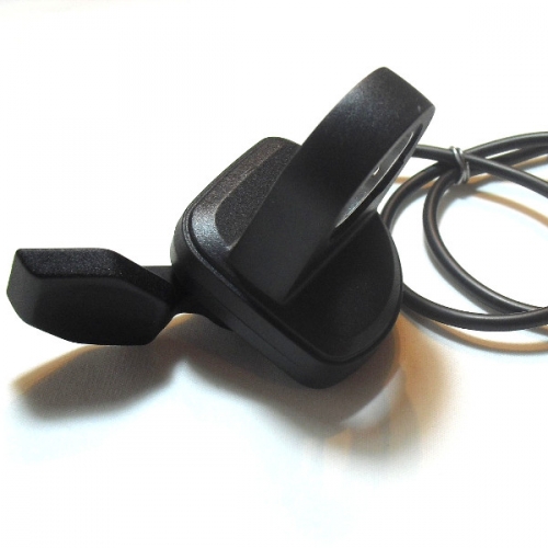

Can a BAFANG (or whoever makes it) left thumb throttle be used instead of the Domino? This one:
The standard kit uses a CA to process the throttle signal, so just like with torque sensing, you can use anything the CA supports.
So from what I gather this kit should be easily convertible to torque PAS. And since it's small, one can even tackle the noise with some makeshift semi-open enclosure, if needed. I think I'm going to pull the trigger in the coming months. It's a bigger investment than BBS02, but the latter is also a large investment so might as well get the right thing from the get go than being sorry down the road.
