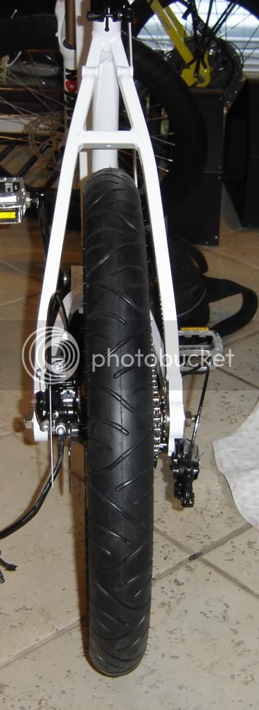

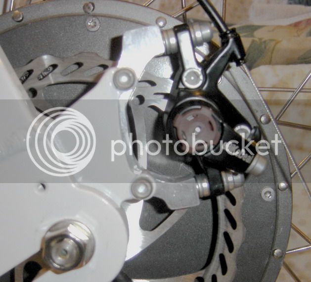

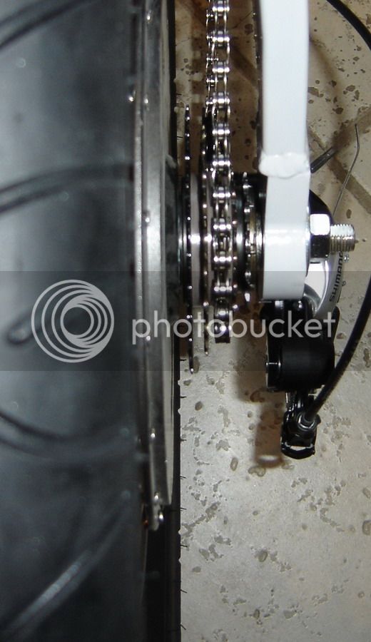

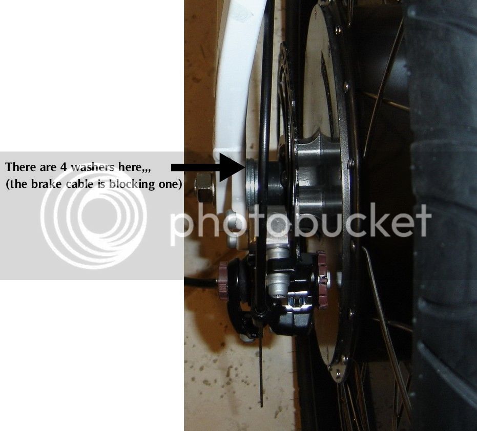

Well as you know there was a hiccup with the frame or rather a discovery. Ive been in contact with Max Kogan. My problem is his problem because if its an issue with one frame its an issue with all frames and hes been working hard to correct a design issue that affected motor alignment. It also affected disc brake alignment. This problem He has a fix that should be in my hands shortly. I believe the 150mm drop out combined with the Mxus 142mm drop out width made for bad alignment. Especially if you want to run a 7 speed freewheel. The Crystalyte 4060 has 135mm drop out and will have more left to right movement to allow you to shim it in the correct direction to align with the center line of the frame. This may not seem like much but in a 150mm drop out thats alot of room to shim it one way or another. With this info and some photos to show what has been done I have made several more purchases. I found and purchased the ammo cans that will fit the 100v 16AH and 100v 32AH packs. I also contacted a metal fabrication shop that can either make my box wider or make a totally different box similar to my ammo box that fit in my frame. Its going to cost money but the idea of this build was to have the long range so a new battery container is a must cause the stock one just wont do. I will explain my issues with the stock battery box in the next. Atleast the problems that cause an issue while running lipo.

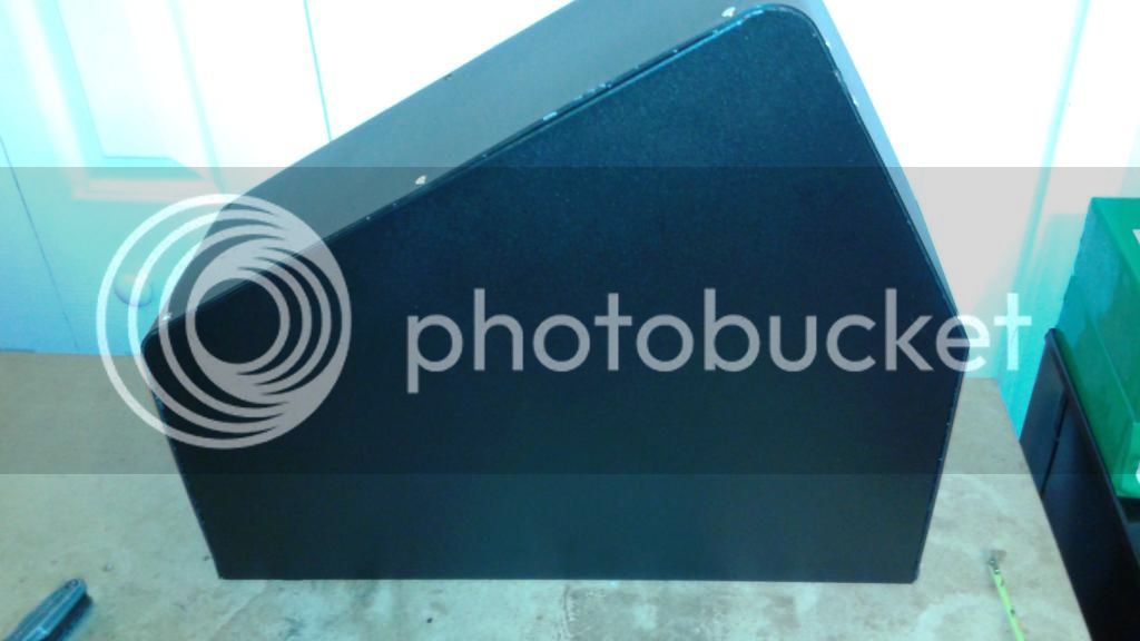

For normal builds the stock battery boxes will be ok for most people but for a person like me that is trying to shove the most in a frame he can the regular version of the box and the large version of the box weren't big enough for my needs.

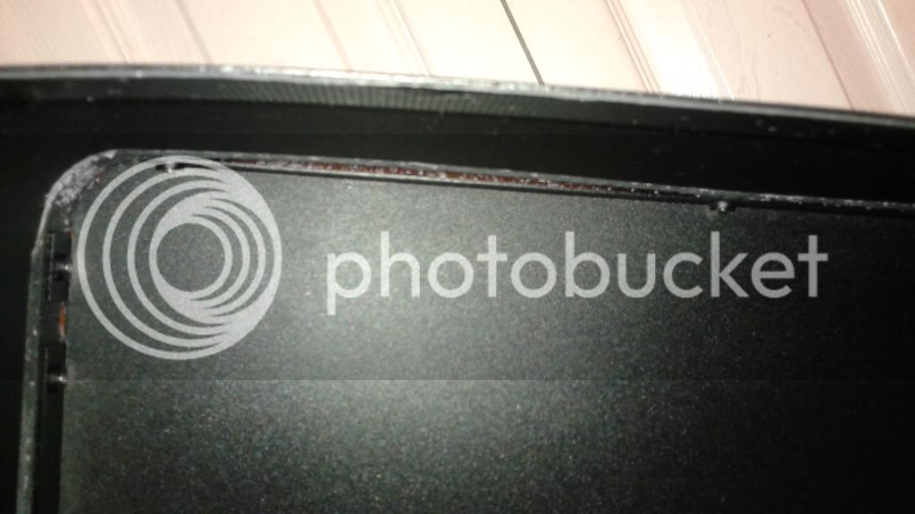

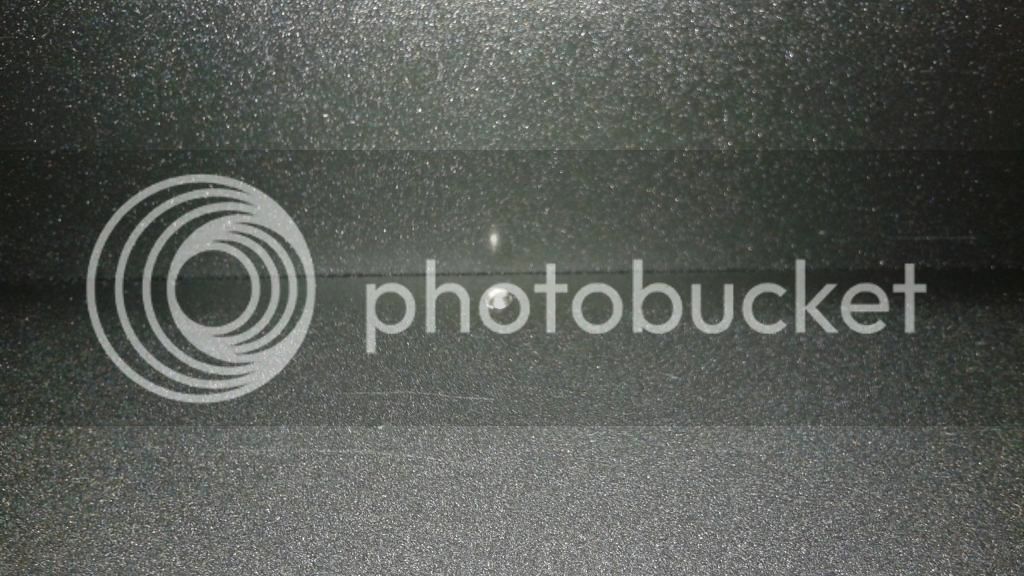

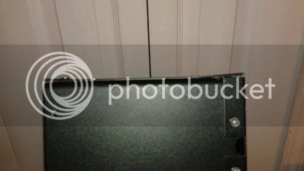

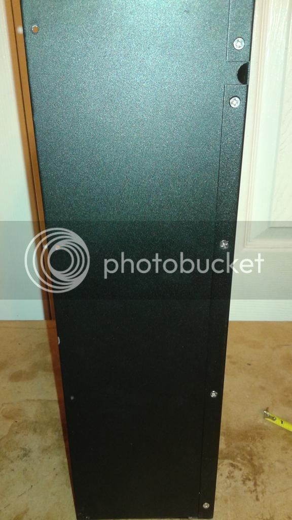

The box was designed for use with headway cells. You can use it for other stuff but you have to be creative on how you pack the batteries. The box is constructed from several sheets of metal. For me the box went together but only with a little persuasion. The box kinda has to be loosely put together so all the screws find their holes then you have to go around to box and slowly tighten all the screws. When you do this the process will put the box in alignment. He did think to include a double sided tape along the seams where the box is joined but it doesn't do much in bonding the sides or closing the air gaps. If you want a weather poof box I advise to run you own bead of silicone around the seams of the box as you put it together.

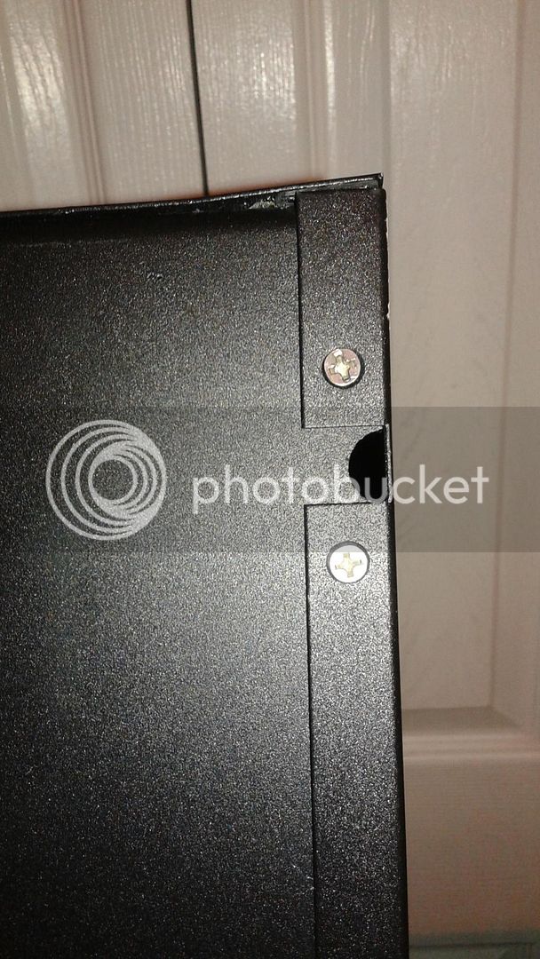

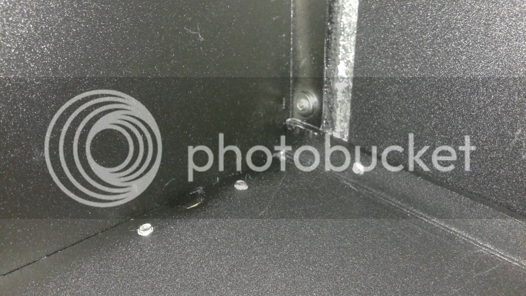

Another pet peeve is the screws that bring it all together have some of the shaft sticking through the box so you cant just put bare lipo packs in there. You have to line the box with some material to cover the screws. They arent point or anything they just protrude around the edges of the box 1-2mm and I know that shortly overtime this could puncture a lipo cell. You can get some materials such as carpet padding and line the sides of the box. This gives the pack padding and spaces it away from the screws while protecting it from shock and vibration. This fills up dead space. It shifts the pack to the center of the box away from the screws. This can be easily achieved with some contact cement spray and lining the container with the carpet padding.
Another problem I see is if you run lipo... once the box is made and pack is in side and sealed you cant easily get access to the contents of the box. This box is clearly made for a pack that has its own bms. Meaning The only thing the box should have on it is a charge an discharge port but its not meant to be a serviceable pack. That is why Im so set on creating removable battery box. I don trust BMSs. I like to monitor my packs on every charge cycle so I can judge their performance on a cycle by cycle basis.
Another thing since the box is mean to stay on the bike the side straps that hold the box in are M8 bolts to where you need an Allen wrench to remove the straps and remove the box. Since I plan to make mines removable Im going to replace this bolts with winged head bolts so its a little bit more user friendly. I will post pictures shortly.
This is Max's solution for my issue. A custom disc brake adapter to space out the caliper to mate with the disc brake rotor. This and the motor and extra trinkets are in the mail. I have everything at the bike shop. Waiting on the motor to see how this drops in and works out for me.

Nice bike icecube57, good to see your mxus spokes all pointing towards the disc.
