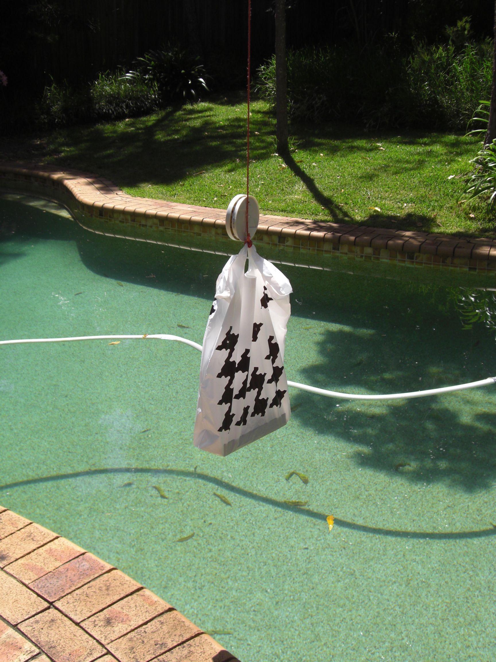

guys, ..may i remind you of my previous posts (2012) on a safe lipo storage method...
Hillhater said:
All these .. "Beware ..Fire ! " .. type posts recently, have left me with restless nights as my lipo is ( was) stored in the garage under my bedroom !
now i dont for one minute doubt my limited ability to take care of the lipo, but i decided a good nights sleep warranted a little thought.
..So, i "dreamed" up this "Total safety" solution to lipo storage.
A fully automatic storage, detection, and fire control / containment /suppression system, that can be done easily and cheaply by most lipo users.
I have the benefit of a large water storage device ( Swim pool0 that should be capable of containing most runaway lipo events, but what i needed was a system for detecting thermal runaway, and rapidly quenching the problem.
Problem solved by a plastic carry bag, a piece of poly string, and a battery fire alarm !
The bag holds the lipo packs, the string suspends the bag over the pool, and the alarm is atttached to the string ( could be in the bag ?).
If the lipo decides to flame, it will melt the bag, drop into the pool, and set off the alarm ! :shock: :lol: :roll:
( actually, i have such confidence in the functionality of the system , i may eliminate the alarm to enable an undisturbed sleep ! :wink: )
The pool is maybe a little overkill, the Spa, or a bucket of water, or even the bath tub could be used for those in an apartment.
Plenty of room for improvements ( Gucchi bag ?), splash detector ? etc etc...feel free to adapt for yourself ! :wink: :wink: :lol:
That's actually a pretty good plan. Water won't put out a lipo fire, but dropping that fire in water is bound to hrelp prevent it from setting the motorcycle full of gas next to it on fire. 8) This is assuming you don't have 2000wh in that pack though. Outside, I'd let it burn before I trashed my swimming pool with a burning lipo pack.
