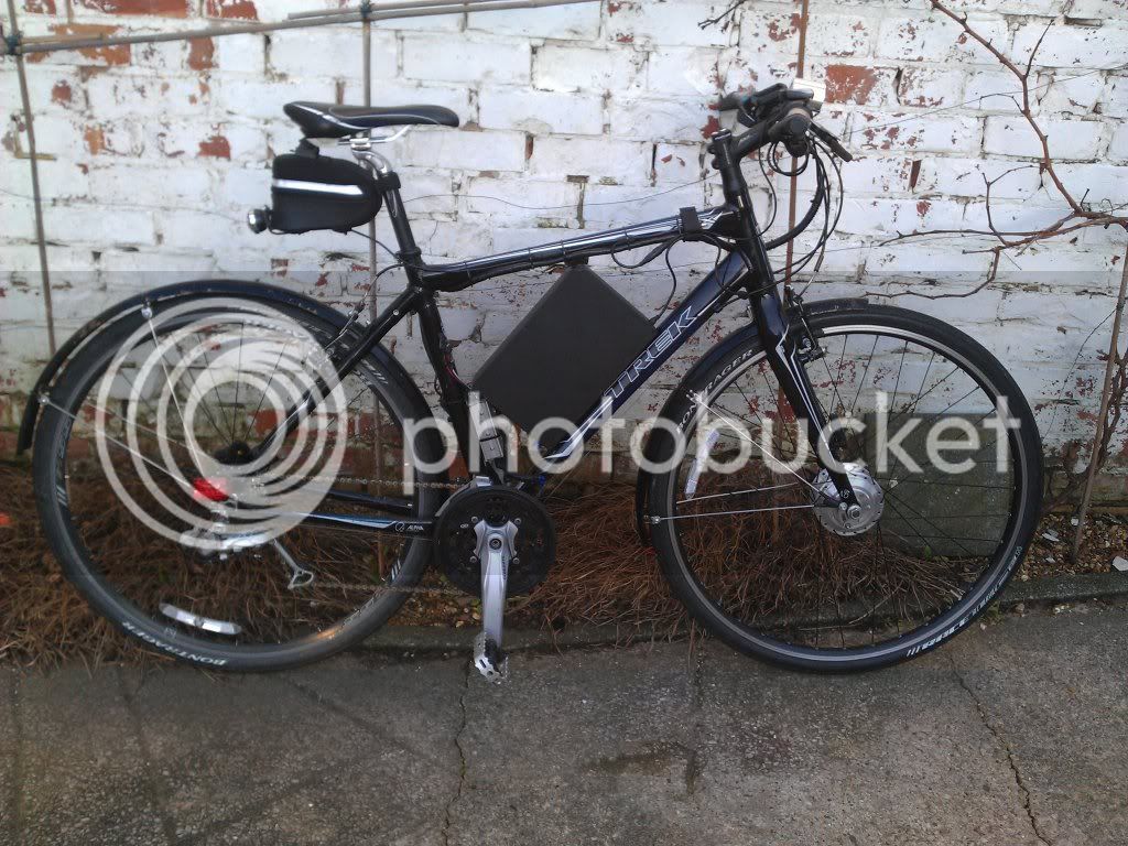

This carbon fork with alloy dropouts and a front motor will make many of you cringe then :)
Just passed 1000 miles on it.
You are pushing your luck by not using arm torque. You don't know if you are near the limit.
It would make me cringe if it had any power. Properly installed, nut torque alone is proven to provide enough resistance for lower torque levels. And I do see a torque arm.

I am using a torque arm - look closer :)
EDIT: I see you've noticed :)
Yeah, it's only pulling 750w max.
