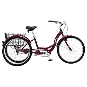

Bargain price on Schwinn Meridian Adult 26-Inch 3-Wheel Bike.
Walmart and Amazon both offering them at $239, with free shipping.
That's deep enough into the oh-so-cheap range that it starts to look worth it just for the frame and rear axle assembly. It would not be ridiculously expensive to lace some decent rims on those rear hubs, and maybe switch to a dual crown chopper fork with a disc or drum brake in front.
Then you could reduce the wheel diameter to 24", or with shorter cranks, even 20". That would yield stronger wheels, lower step-through, and lower center of mass-- all good things for a mobility device.

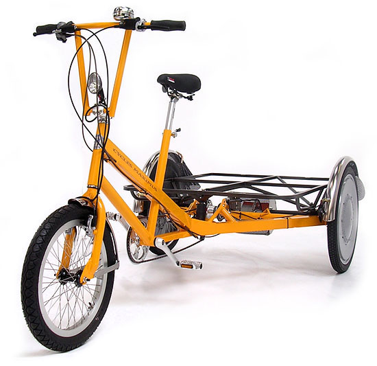

I have never seen a granny trike with brakes on all three wheels, except old ones with a differential gear coupled to a coaster brake.
The Cycles Maximus pedicab/cargo trike meets your criteria more or less (it comes stock with a hydraulic rim brake in front, and the rear wheels are some slightly larger than 20" moped size), but it's very large, very heavy, and very expensive.
Price list for Cycles Maximus trikes
Most trikes need enough material to provide adequate stiffness that using chromoly rather than ordinary high tensile steel is not of much benefit. That is, if they have enough material to be adequately stiff, they are more than strong enough for the job. (Some are not stiff enough or strong enough, so caveat emptor.)
That's weird, isn't it. One would thought that granny tricycles are those that need the best brakes. I would hate to be old and going down a hill on a tricycle with wimpy brakes.
The pedicab and/or cargo trikes are not what I'm looking for. Just a small, light and well built traditional tricycle.
In the end I might end up with a Sun recumbent delta trike. About 2 feet longer than what I want.
