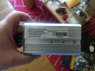

Hi,
I am one of them who have got a replacement Fiido T1 beacuse of OG bikes frame had problems with cracks and breaking.
But i was not satisfied with controller in the new one beacuse it cutts out pedal assist at 25kph so i swapt it out for OG one
and in the process i opend the controller and thougt that i would do a quick shunt mod for some more power,
but the controller does not have shunts like i am used to see.
Does anyone know where the shunts a located or how to beef up amps on this controller?

This is a FOC controller, it has a SMD resistor in each phase rail for phase current sensing. It's a Lishui clone propably. Similar controller PCB:
fetch.php
You don't have to mod the shunts, just flash the right firmware ;)
regards
stancecoke

Thanks,
Tell me more about flashing the firmeware?, i think there is a wire for flashing allredy there is one 4pin not connected to anything.
@Deuin in the german forum has successfully flashed a very similar controller of a Himiway Cobra:
It was a little tricky as there are small differences in the pin functions compared to the original Lishui hardware, but finally we had a working branch for this kind of controllers.
regards
stancecoke

Wow thanks,
It's all very interesting but its pretty much greek for me that and the fact that i have to use google translate does not make it easier.
I have to start with which type of programing lead to use, could i modify a lead for bafang bbs? i also have a lead for golden motor and cables for grintech devices.
Or maybe i should just buy a lishui controller rated at 30A, would be the easiest way but not as fun.
