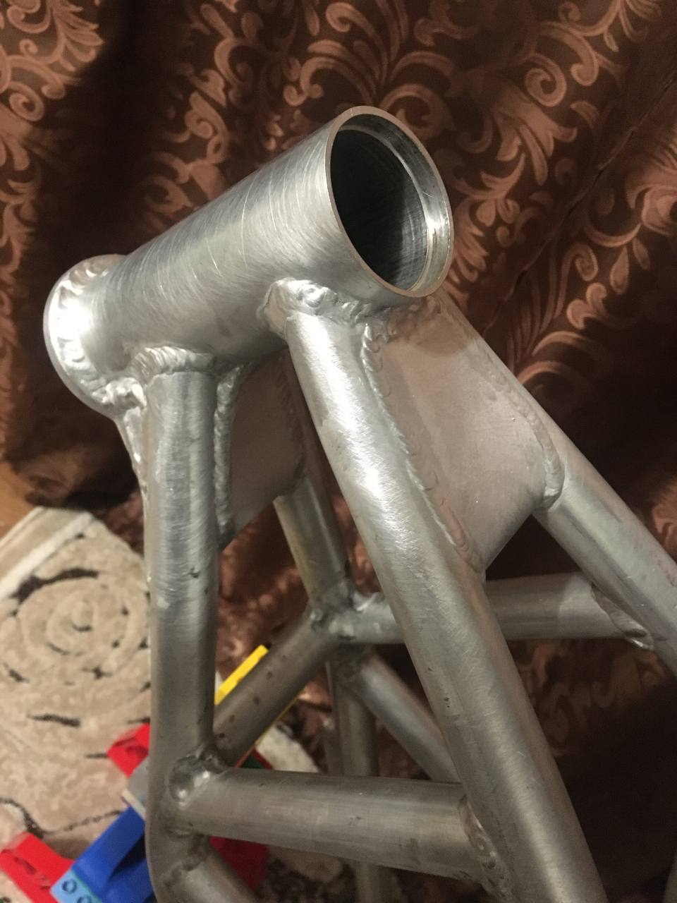

During the tests, we tore the frame on a big drop, and from now on I will be strengthening this place
[img=https://illegalbike.ru/uploads/for_web/crash1.JPG][/img]
[img=https://illegalbike.ru/uploads/for_web/crash2.JPG][/img]
[img=https://illegalbike.ru/uploads/for_web/crash3.JPG][/img]
[img=https://illegalbike.ru/uploads/for_web/crash4.JPG][/img]
[img=https://illegalbike.ru/uploads/for_web/crash5.JPG][/img]
[img=https://illegalbike.ru/uploads/for_web/crash6.JPG][/img]

And bad luck on smashing that wheel and cracking the frame. But props for sharing! More metal there I guess. They always crack at the head tube.
[img=https://illegalbike.ru/uploads/for_web/repair1.jpeg][/img]
[img=https://illegalbike.ru/uploads/for_web/repair2.jpeg][/img]
[img=https://illegalbike.ru/uploads/for_web/repair4.jpeg][/img]
[img=https://illegalbike.ru/uploads/for_web/repair5.jpeg][/img]
[img=https://illegalbike.ru/uploads/for_web/repair6.jpeg][/img]

My thought is that you should have between the top and down tubes a plate that takes the shear force between them.
At the moment, while your joints are stronger, the same load that's caused your failure exists.
