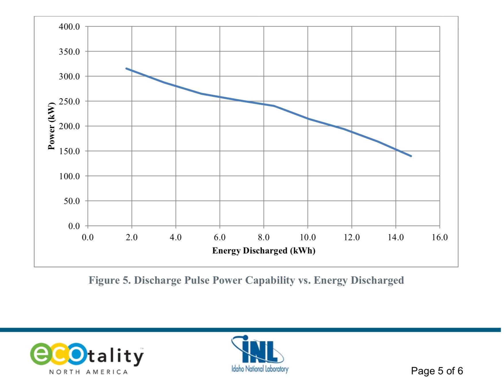

DogDipstick said:
Just buy a recycled Volt module.... tested and proven to be 1000A capable, .....
? But for how long ??. 10 sec ??.
Indepemdent testing b the US Department of Energy, of the bare volt pack showed its maximum 10 sec PULSE capability was somewhat short of that (300kW ),..at full charge. And reduced significantly as capacity reduced (<250kW ) @50% SOC and 150 kW at 20% SOC.....remember those are 10sec pulse tests. !
I wonder what it does under a continuous 90 sec max discharge test. ! ?
Sounds like a fun project. Can I ask how you estimated 90-sec. run time?
While motor current will ideally be maxed for an entire run, battery current will not be. I know of one team who ran the long course who used 4-6 kWh total energy, including driving 3 miles from the pits, returning 5-6 miles up the return road (to the start area) then driving the 3 miles back to the pits. I suspect 10 kWh design energy is reasonable.
I drag race with Sleeper cells and have also exceeded 200 mph on a pavement course using them. I always design for much less than the rated C-rate ex. the 4P pack on the LSR bike drew a max of 500A and that for only a short time. I run the 3P pack in my drag bike a bit harder but typically not exceeding 900A peak draw. The 6S packs use 8 AWG wires but the new 12S packs have dual 8 AWG (I think it's #8) and would be a better choice for a longer run. Some of the cells in my drag bike are from 2014 and still hanging in there really well. These are expensive but very good cells. I just took apart my drag bike pack and with the exception of 3 bricks, the entire pack was sitting < .013 V total difference (about what I balance to); last time they were charged was August '19. The 3 bricks were at .05 V difference which isn't too bad but makes me wonder if one or 2 cells in the bricks aren't getting weak.
Something to think about is that LiPo's typically sag at a fairly constant rate. If you could identify a cell with more linear sag characteristics (A123?) so that after the initial "knee" drop-off the discharge would occur in a more linear fashion - you would preserve voltage for the end of the run where it really counts. You could oversize the S-rating of the pack and partially discharge the pack before a run (ex. using baseboard heaters) so they would be sitting at a more linear part in the discharge curve.
Regardless, nothing says you can't start with hobby level cells and see how things go, you'll have plenty to worry about with a new build anyway. I don't know much about the Volt cells but access to liquid cooling might be important. Also, have you looked at Enerdel? I don't even know their business status at this time but their cells are pretty robust (NMC) but sag a bit more than other types of lithium. Given the state of the salt I'd also be thinking about running on pavement.
